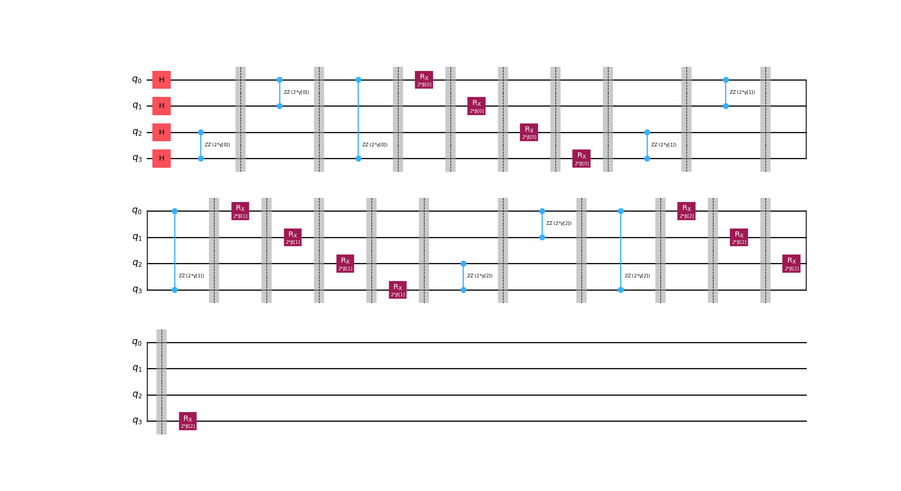

To define the QAOA ansatz we require a cost Hamiltonian, encoding the classical optimization problem:
from qiskit.quantum_info import SparsePauliOp
from qiskit.circuit.library import qaoa_ansatz
cost_operator = SparsePauliOp(["ZZII", "IIZZ", "ZIIZ"])
ansatz = qaoa_ansatz(cost_operator, reps=3, insert_barriers=True)
ansatz.draw("mpl")
Circuit diagram output by the previous code.
