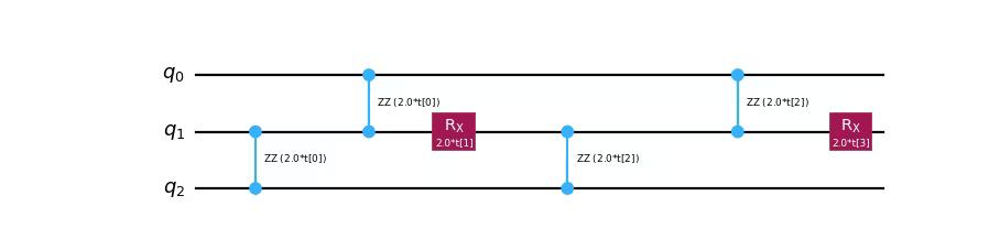

# this Hamiltonian will be split into the two terms [ZZI, IZZ] and [IXI]
hamiltonian = SparsePauliOp(["ZZI", "IZZ", "IXI"])
ansatz = hamiltonian_variational_ansatz(hamiltonian, reps=2)
ansatz.draw("mpl")
Circuit diagram output by the previous code.

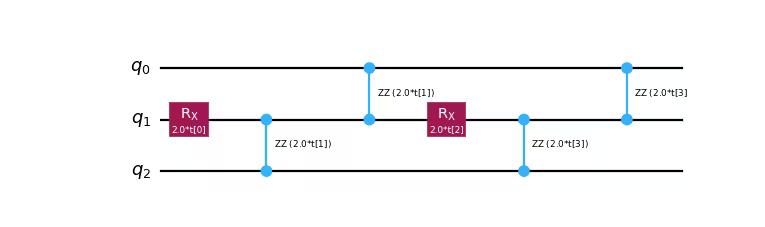

zz = SparsePauliOp(["ZZI", "IZZ"])
x = SparsePauliOp(["IXI"])
ansatz = hamiltonian_variational_ansatz([zz, x], reps=2)
ansatz.draw("mpl")
