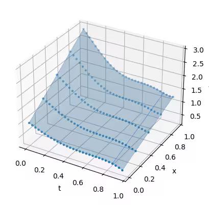

Computational Fluid Dynamics (CFD)
When initial conditions are set to u(0,x)=xu(0,x) = x, the results are as follows:
# launch the simulation with initial conditions u(0,x) = a*x + b
job = quick.run(use_case="cfd", physical_parameters={"a": 1.0, "b": 0.0})
Check your Qiskit Function workload's status or return results as follows:
# Print the ID so you can use it later, if necessary
print(job.job_id)
print(job.status())
solution = job.result()
import numpy as np
_ = plt.figure()
ax = plt.axes(projection="3d")
# plot the solution using the 3d plotting capabilities of pyplot
t, x = np.meshgrid(solution["samples"]["t"], solution["samples"]["x"])
ax.plot_surface(
    t,
    x,
    solution["functions"]["u"],
    edgecolor="royalblue",
    lw=0.25,
    rstride=26,
    cstride=26,
    alpha=0.3,
ax.scatter(t, x, solution["functions"]["u"], marker=".")
ax.set(xlabel="t", ylabel="x", zlabel="u(t,x)")
plt.show()

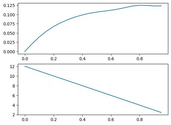

Material deformation
The material deformation use case requires the physical parameters of your material and the applied force, as follows:
# select the properties of your material
job = quick.run(
    use_case="md",
        "t": 12.0,
        "K": 100.0,
        "n": 4.0,
        "b": 10.0,
        "epsilon_0": 0.1,
        "sigma_0": 5.0,
# plot the result
_ = plt.figure()
stress_plot = plt.subplot(211)
plt.plot(solution["samples"]["x"], solution["functions"]["u"])
strain_plot = plt.subplot(212)
plt.plot(solution["samples"]["x"], solution["functions"]["sigma"])
plt.show()
