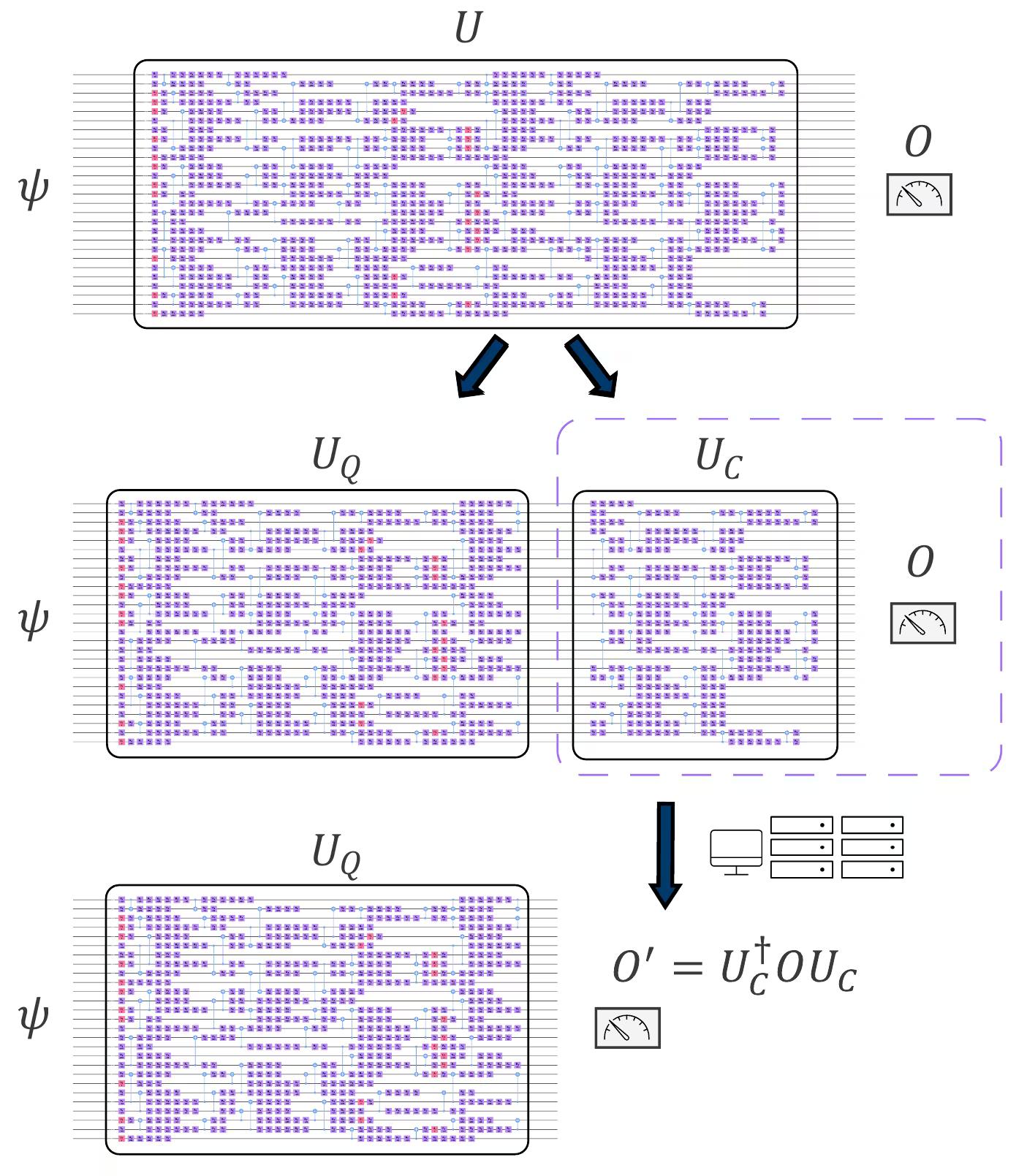

To distribute this problem across both classical and quantum resources, split the circuit UU into two subcircuits, UCU_C and UQU_Q, classically simulate the circuit UCU_C, then execute the circuit UQU_Q on quantum hardware and use the results of the classical simulation to reconstruct the measurement of the observable OO.
OBP diagram depicting splitting a circuit into two subcircuits, classically computing one of the subcircuits, then measuring the other circuit using quantum hardware
The subcircuit UCU_C should be selected to be classically simulable and will compute the expectation value
OUCOUC,\langle O' \rangle \equiv U_C^\dagger O U_C,
which is the version of the initial operator OO evolved through the circuit UCU_C. Once OO' has been determined, the quantum workload is prepared wherein the state ψ|\psi\rangle is initiated, has the circuit UQU_Q applied to it, and then measures the expectation value OO'. You can show that this is equivalent to measuring O\langle O \rangle by writing:
ψUQOUQψ=ψUQUCOUCUQψ=ψUOUψ=OUψ \langle \psi | U_Q^\dagger O' U_Q \psi \rangle = \langle \psi | U_Q^\dagger U_C^\dagger O U_CU_Q \psi \rangle = \langle\psi | U^\dagger O U |\psi \rangle = \langle O \rangle_{U|\psi\rangle}
