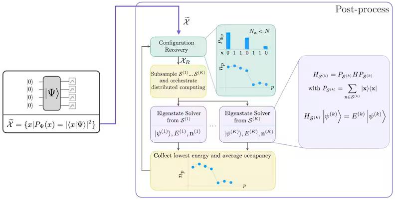

SQD-based workflows involve first preparing one or more quantum states on a quantum device and sampling from them. Then, classical distributed computing is used to process those noisy samples. This processing occurs iteratively in two steps: first, a configuration recovery step corrects noisy samples using information about the input problem; second, the Hamiltonian is projected and diagonalized in the subspace spanned by those samples. These steps are repeated self-consistently until convergence. The result is an approximated lowest eigenvalue (energy) and lowest energy eigenstate of a given Hamiltonian. SQD is robust to samples corrupted by quantum noise; in fact, as long as a useful signal can be retrieved out of the quantum computer, the outcome of SQD will be insensitive to noisy bitstrings.

The computational cost of SQD is dominated by the eigenstate solver calls. At each step of the self-consistent configuration recovery iteration, n_batches of eigenstate solver calls are performed. The different calls are embarrassingly parallel. In this tutorial, those calls are inside a for loop. It is highly recommended to perform these calls in parallel.
