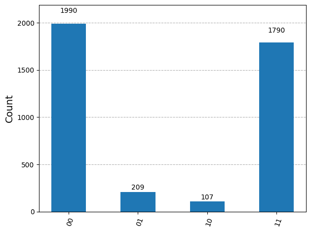

For example, make a two-qubit Bell state:
from qiskit.primitives import StatevectorSampler as Sampler
from qiskit.transpiler import generate_preset_pass_manager
from qiskit.visualization import plot_histogram
# Quantum circuit to make a Bell state
bell = QuantumCircuit(2)
bell.h(0)
bell.cx(0, 1)
bell.measure_all()
pm = generate_preset_pass_manager(optimization_level=1)
isa_circuit = pm.run(bell)
# execute the quantum circuit
sampler = Sampler()
job = sampler.run([isa_circuit])
result = job.result()
print(result)
Output:
PrimitiveResult([SamplerPubResult(data=DataBin(meas=BitArray(<shape=(), num_shots=1024, num_bits=2>)), metadata={'shots': 1024, 'circuit_metadata': {}})], metadata={'version': 2})
plot_histogram(result[0].data.meas.get_counts())
Output:
Output of the previous code cell

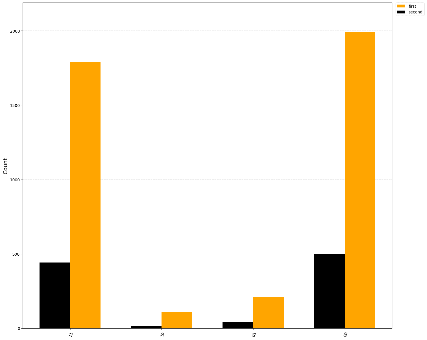

Options when plotting a histogram
Use the following options for plot_histogram to adjust the output graph.
  • legend: Provides a label for the executions. It takes a list of strings used to label each execution's results. This is mostly useful when plotting multiple execution results in the same histogram
  • sort: Adjusts the order of the bars in the histogram. It can be set to either ascending order with asc or descending order with desc
  • number_to_keep: Takes an integer for the number of terms to show. The rest are grouped together in a single bar called "rest"
  • color: Adjusts the color of the bars; takes a string or a list of strings for the colors to use for the bars for each execution
  • bar_labels: Adjusts whether labels are printed above the bars
  • figsize: Takes a tuple of the size in inches to make the output figure
# Execute two-qubit Bell state again
job = sampler.run([isa_circuit], shots=1000)
second_result = job.result()
# Plot results with custom options
plot_histogram(
        result[0].data.meas.get_counts(),
        second_result[0].data.meas.get_counts(),
    legend=["first", "second"],
    sort="desc",
    figsize=(15, 12),
    color=["orange", "black"],
    bar_labels=False,
Output:

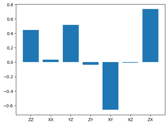

Plot Estimator results
Qiskit does not have a built-in function for plotting Estimator results, but you can use Matplotlib's bar plot for a quick visualization.
To demonstrate, the following cell estimates the expectation values of seven different observables on a quantum state.
import numpy as np
from qiskit.quantum_info import SparsePauliOp
from qiskit.primitives import StatevectorEstimator as Estimator
from matplotlib import pyplot as plt
# Simple estimation experiment to create results
qc = QuantumCircuit(2)
qc.h(0)
qc.crx(1.5, 0, 1)
observables_labels = ["ZZ", "XX", "YZ", "ZY", "XY", "XZ", "ZX"]
observables = [SparsePauliOp(label) for label in observables_labels]
isa_circuit = pm.run(qc)
isa_observables = [
    operator.apply_layout(isa_circuit.layout) for operator in observables
# Reshape observable array for broadcasting
reshaped_ops = np.fromiter(isa_observables, dtype=object)
reshaped_ops = reshaped_ops.reshape((7, 1))
estimator = Estimator()
job = estimator.run([(isa_circuit, reshaped_ops)])
result = job.result()[0]
exp_val = job.result()[0].data.evs
print(result)
# Since the result array is structured as a 2D array where each element is a
# list containing a single value, you need to flatten the array.
# Plot using Matplotlib
plt.bar(observables_labels, exp_val.flatten())
Output:
PubResult(data=DataBin(evs=np.ndarray(<shape=(7, 1), dtype=float64>), stds=np.ndarray(<shape=(7, 1), dtype=float64>), shape=(7, 1)), metadata={'target_precision': 0.0, 'circuit_metadata': {}})
<BarContainer object of 7 artists>

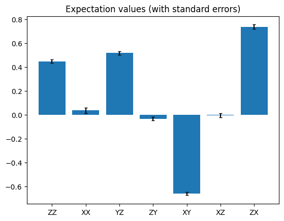

The following cell uses the estimated standard error of each result and adds them as error bars. See the bar plot documentation for a full description of the plot.
standard_error = job.result()[0].data.stds
_, ax = plt.subplots()
ax.bar(
    observables_labels,
    exp_val.flatten(),
    yerr=standard_error.flatten(),
    capsize=2,
ax.set_title("Expectation values (with standard errors)")
Output:
Text(0.5, 1.0, 'Expectation values (with standard errors)')
