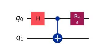

theta = Parameter(r"$\theta$")
chsh_circuit = QuantumCircuit(2)
chsh_circuit.h(0)
chsh_circuit.cx(0, 1)
chsh_circuit.ry(theta, 0)
chsh_circuit.draw(output="mpl", idle_wires=False, style="iqp")
Output:
Output of the previous code cell

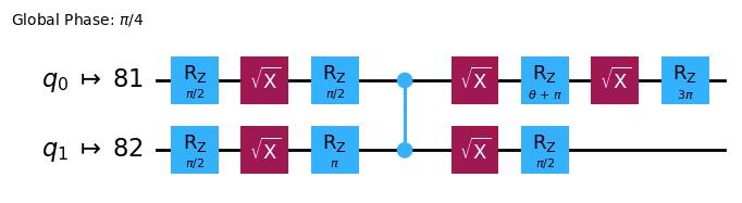

chsh_isa_circuit = pm.run(chsh_circuit)
chsh_isa_circuit.draw(output="mpl", idle_wires=False, style="iqp")
Output:

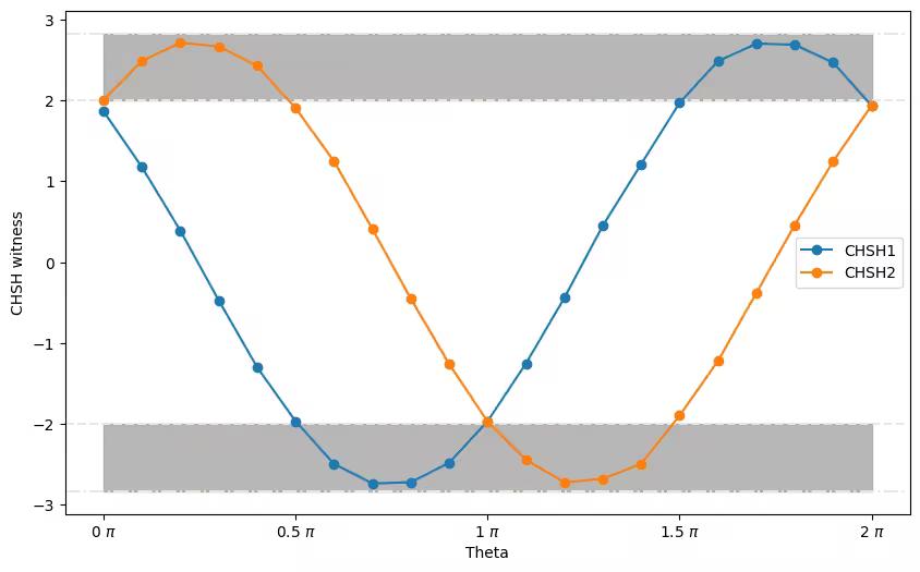

The Estimator returns expectation values for both observables. We plot them against θ\theta together with the classical bound (±2\pm 2) and the Tsirelson bound (±22\pm 2\sqrt{2}). The shaded grey regions mark the gap between the two. Points that lie inside these bands violate the CHSH inequality.
chsh1_sim = sim_result[0].data.evs[0]
chsh2_sim = sim_result[0].data.evs[1]
def plot_chsh(phases, chsh1, chsh2, title):
    fig, ax = plt.subplots(figsize=(10, 6))
    ax.plot(
        phases / np.pi, chsh1, "o-", label=r"$\langle S_1 \rangle$", zorder=3
    ax.plot(
        phases / np.pi, chsh2, "o-", label=r"$\langle S_2 \rangle$", zorder=3
    # classical bound +-2
    ax.axhline(y=2, color="0.9", linestyle="--")
    ax.axhline(y=-2, color="0.9", linestyle="--")
    # quantum bound, +-2*sqrt(2)
    ax.axhline(y=np.sqrt(2) * 2, color="0.9", linestyle="-.")
    ax.axhline(y=-np.sqrt(2) * 2, color="0.9", linestyle="-.")
    ax.fill_between(phases / np.pi, 2, 2 * np.sqrt(2), color="0.6", alpha=0.7)
    ax.fill_between(
        phases / np.pi, -2, -2 * np.sqrt(2), color="0.6", alpha=0.7
    ax.xaxis.set_major_formatter(tck.FormatStrFormatter("%g $\\pi$"))
    ax.xaxis.set_major_locator(tck.MultipleLocator(base=0.5))
    ax.set_xlabel(r"$\theta$")
    ax.set_ylabel("CHSH witness")
    ax.set_title(title)
    ax.legend()
    plt.show()
plot_chsh(
    phases,
    chsh1_sim,
    chsh2_sim,
    "CHSH witnesses from AerSimulator (ibm_pittsburgh noise model)",
Output:
The simulator's CHSH witnesses already exceed the classical bound of ±2\pm 2 at several values of θ\theta, even with the backend's noise model. The peaks fall just short of the Tsirelson bound ±22\pm 2\sqrt{2} because of simulated device noise. With the workflow validated, we move on to actual hardware.

Tiling ibm_pittsburgh with 64 parallel Bell pairs (128 of 156 qubits)
Job ID: d86efd5g7okc73el0rp0
63/64 Bell pairs violated the CHSH inequality (mean peak witness 2.75, classical bound 2)
The faint curves are the individual Bell pairs and the bold curves are their mean across the device. Every pair traces the same sinusoid predicted by quantum mechanics, and the spread between the faint curves reflects the variation in noise from pair to pair. Wherever a curve enters the grey bands, it has crossed the classical bound of ±2\pm 2, and the printed summary confirms that essentially every pair violates the CHSH inequality at the same time.
The peaks fall short of the Tsirelson bound ±22\pm 2\sqrt{2} because of device noise, but the conclusion is unambiguous: the backend sustains genuine entanglement across the whole chip simultaneously, not just on a single hand-picked pair. This is the sense in which the CHSH experiment "scales": not as one larger circuit, but as a parallel benchmark that certifies entanglement everywhere at once.
