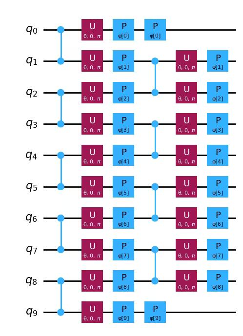

Construct the 1D MBL circuit
First, we present a function for constructing the 1D MBL circuit.
class MBLChainCircuit(QuantumCircuit):
    def __init__(
        self, num_qubits: int, depth: int, use_cut: bool = False
    ) -> None:
        super().__init__(
            num_qubits, name=f"MBLChainCircuit<{num_qubits}, {depth}>"
        evolution = MBLChainEvolution(num_qubits, depth, use_cut)
        self.compose(evolution, inplace=True)
class MBLChainEvolution(QuantumCircuit):
    def __init__(self, num_qubits: int, depth: int, use_cut) -> None:
        super().__init__(
            num_qubits, name=f"MBLChainEvolution<{num_qubits}, {depth}>"
        theta = Parameter("θ")
        phis = ParameterVector("φ", num_qubits)
        for layer in range(depth):
            layer_parity = layer % 2
            # print("layer parity", layer_parity)
            for qubit in range(layer_parity, num_qubits - 1, 2):
                # print(qubit)
                self.cz(qubit, qubit + 1)
                self.u(theta, 0, np.pi, qubit)
                self.u(theta, 0, np.pi, qubit + 1)
                if (
                    use_cut
                    and layer_parity == 0
                    and (
                        qubit == num_qubits // 2 - 1
                        or qubit == num_qubits // 2
                    self.append(CutWire(), [num_qubits // 2])
                if use_cut and layer < depth - 1 and layer_parity == 1:
                    if qubit == num_qubits // 2:
                        self.append(CutWire(), [qubit])
            for qubit in range(num_qubits):
                self.p(phis[qubit], qubit)
num_qubits = 10
depth = 2
mbl = MBLChainCircuit(num_qubits, depth)
mbl.draw("mpl", fold=-1)
Output:
Output of the previous code cell

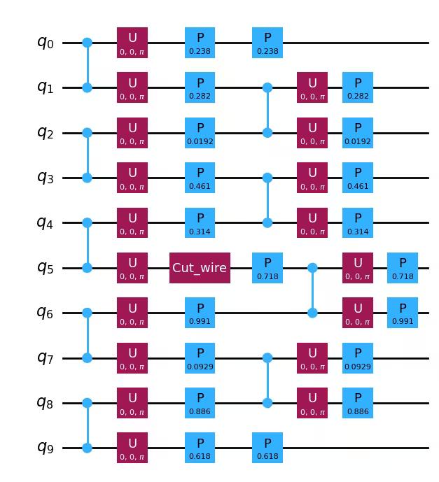

The circuit needs to be annotated by inserting CutWire in the desired locations to partition it. For this tutorial, we opt for equal partition. The MBL circuit is designed so that setting use_cut=True in the function inserts the annotation properly after n2\frac{n}{2} qubits, nn being the number of qubits in the original circuit. We also assigned the randomly generated parameters to the circuit.
mbl_cut = MBLChainCircuit(num_qubits, depth, use_cut=True)
mbl_cut.assign_parameters(params, inplace=True)
mbl_cut.draw("mpl", fold=-1)
Output:

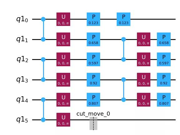

Cut the circuit into smaller subcircuits
Now we partition the circuit into two smaller subcircuits using qiskit-addon-cutting. qiskit-addon-cutting appends a virtual Move gate to split the wire cut location by appropriately adjusting the number of qubits. Now we create the circuit with this virtual gate. Since there is one wire cut, the number of associated qubits will be increased by 1.
mbl_move = cut_wires(mbl_cut)
mbl_move.draw("mpl", fold=-1)
Output:

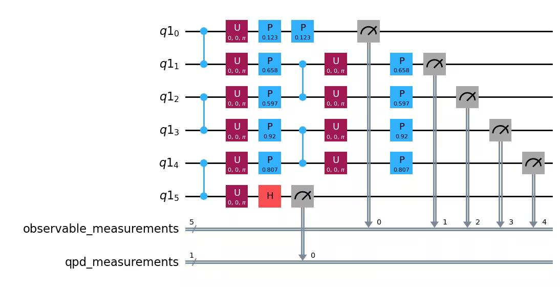

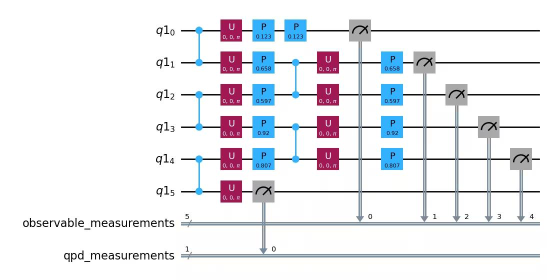

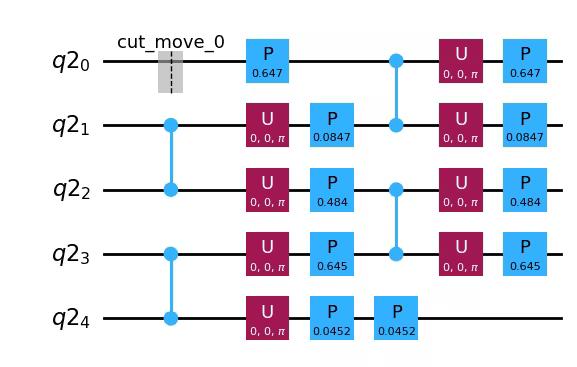

Now the circuit can be partitioned along the Move gate and we obtain the subcircuits, as well as the subobservable, which is the portion of the original observable associated with each subcircuit.
partitioned_problem = partition_problem(circuit=mbl_move, observables=new_obs)
subcircuits = partitioned_problem.subcircuits
subobservables = partitioned_problem.subobservables
Here we visualize the two subcircuits:
subcircuits[0].draw("mpl", fold=-1)
Output:
subcircuits[1].draw("mpl", fold=-1)
Output:

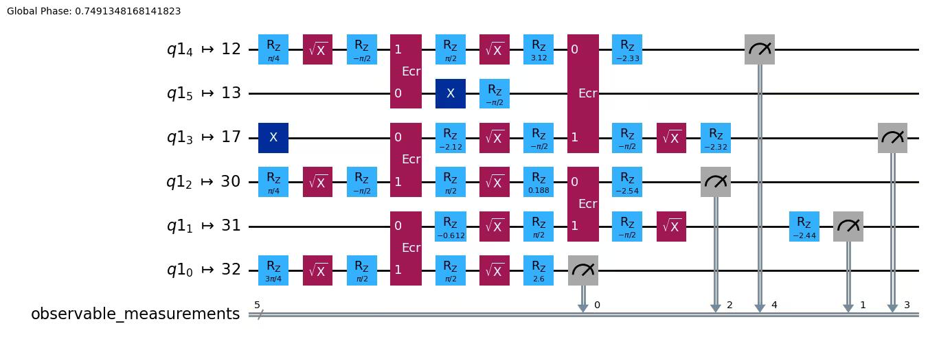

Transpile the circuits onto the backend
For the first example involving only simulation, we transpile the circuit into the basis gate set of the backend:
service = QiskitRuntimeService()
backend = service.least_busy(
    operational=True, simulator=False, min_num_qubits=133
print(backend)
Output:
<IBMBackend('ibm_fez')>

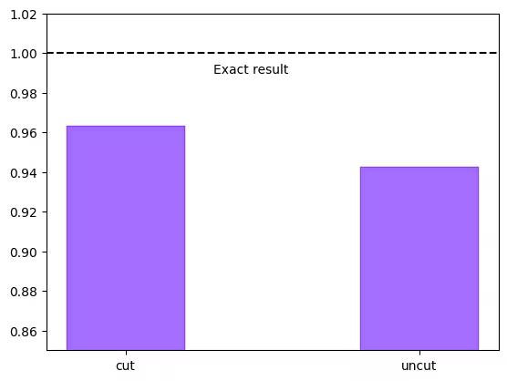

ax = plt.gca()
methods = ["uncut", "cut"]
values = [uncut_expval, reconstructed_expval]
plt.bar(methods, values, color="#a56eff", width=0.4, edgecolor="#8a3ffc")
plt.axhline(y=1, color="k", linestyle="--")
plt.text(0.3, 0.95, "Exact result")
plt.show()
Output:
uncut_expval
Output:
0.9202473958333336
