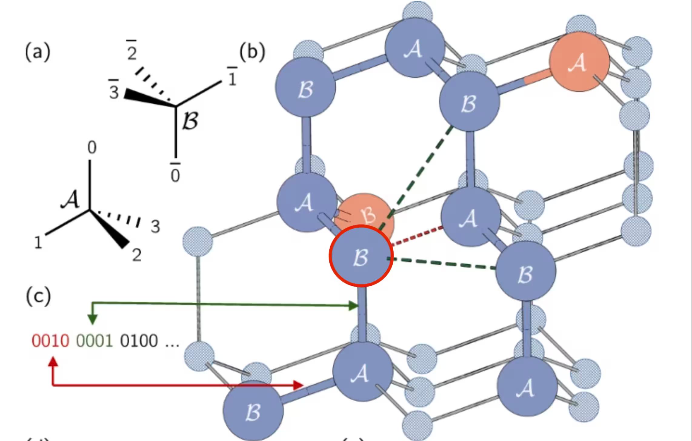

In real proteins, amino acids can occupy a continuum of possible locations. However, we are going to use a simplification and restrict them using a lattice model, where each amino acid occupies a point on a grid. Here, the authors used a tetrahedral lattice. Quick note: here, we are encoding the direction of the edges, not the nodes themselves like in the max-cut problem. Each qubit represents a possible single-step path along the tetrahedral grid. Note that adjacent sites have been labeled as A or B because of their different orientations in the lattice.
The protein chain is represented as a series of turns or directions on this lattice. Each turn between amino acids can be in one of four directions, corresponding to edges of the tetrahedron. These four possible turns are encoded using four qubits into the states 0001, 0010, 0100, or 1000.
Let’s look at an example in the figure above. Let’s place our first amino acid on the point labelled “B” circled in red in our tetrahedral lattice. The direction to the first amino acid to the second is arbitrary because the system can always be rotated to make that edge point in any direction we like. So, we can place our second amino acid on the point below the first labelled “A”. It’s not as easy to see, but the path from the second to the third is also arbitrary. All three choices would result in our having two edges with an angle of approximately 109.5 degrees between them. Picking this second edge simply determines the orientation of our protein in space. So, without loss of generality, we can choose the first two turns to just be0001 and 0010.
With these simplifications, the configuration of the amino acid chain is given by this expression:
So far, we have mapped the tetrahedron edges to qubits, and our quantum circuit will be an ansatz. Now we need to consider how to encode the energy of the problem into a Hamiltonian, so that its ground state gives us the optimal folding pattern.

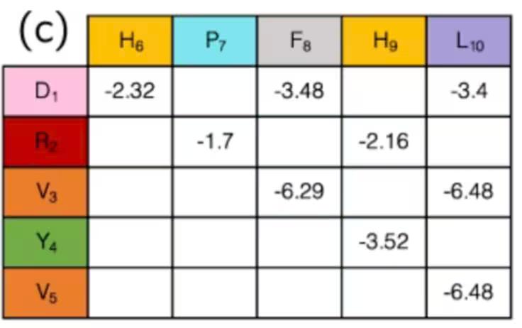

For any given configuration, there will be an associated energy due to interactions between the amino acids. These interactions are strongest when the two amino acids are close to each other. Obviously, amino acids that are adjacent in the backbone of the chain will always interact with each other. But because the protein can twist and fold, other amino acid pairs can also interact. Amino acids 10 and 20 might end up being on adjacent sites after the protein has folded, for example. So, we need a formula to describe the distance between amino acids and using the information encoded on the configuration qubits. That way we can use their separation distance to determine how strongly they are interacting.
First, let’s introduce a function that indicates whether or not an edge is used for the turn at amino acid . Here could take on any of the four possible directions. Based on the configuration we started with above, we can write these functions:
Then we can define a difference in the number of -labeled turns on A and B lattices from index to index as :
Why would we do this? Well, it turns out that a turn of from lattice site A to B is exactly cancelled out by a turn of from lattice site B to A. So to know the distance the amino acid on site is from the one on site , we just need to find the difference between steps made along edges from A sites and B sites. Since A and B sites necessarily alternate along the protein backbone, this is captured in the . This same argument applies to all four edge types. So, the total distance between amino acids in tetrahedral lattice steps can be calculated by this expression:
But how do we get the Hamiltonian from this long equation for the total distance between the amino acids? First, we can convert from the distance in lattice steps to Euclidean space with some simple geometry:
Then, these distances will be used in calculating the energy of protein configuration. Depending on our purposes, we might dictate a cutoff distance below which you consider the pair to be interacting, or you might do something more complicated.
