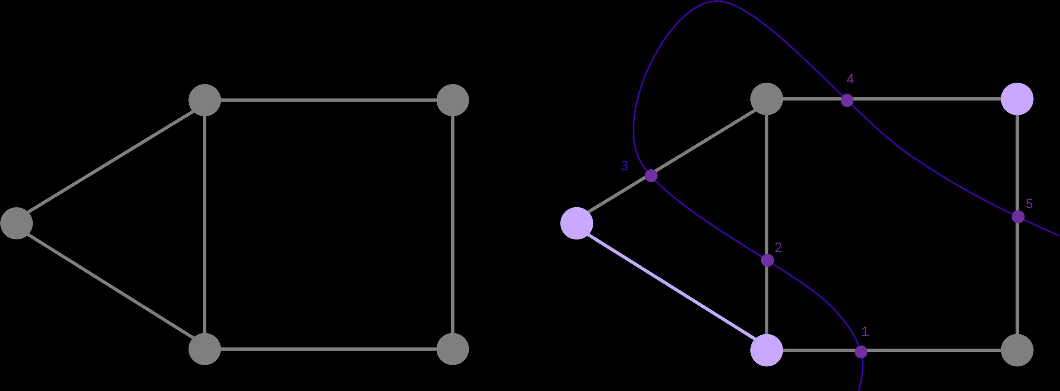

What is max-cut?
We start with a graph, which consists of a collection of vertices (or nodes), some of which are connected by edges. In the problem, we're asked to divide the nodes of the graph into two subsets by “cutting” the edges that connect them. We want to find the partition that maximizes the number of edges that are cut in this way – hence the name, “max-cut.”
Illustration of a max-cut problem
For instance, the figure above shows a five-node graph with a max-cut solution on the right. It cuts through five edges, which is the best one can do with this graph.
Because a five-node graph is so small, it isn't too hard to work out the max-cut in your head or by trying a few cuts on a piece of paper. But as you can imagine, the problem becomes more and more difficult as the number of vertices grows — in part because the number of possible cuts to consider grows exponentially in the number of nodes. And at a certain point, this becomes hard even for supercomputers to do with the any known classical algorithms.

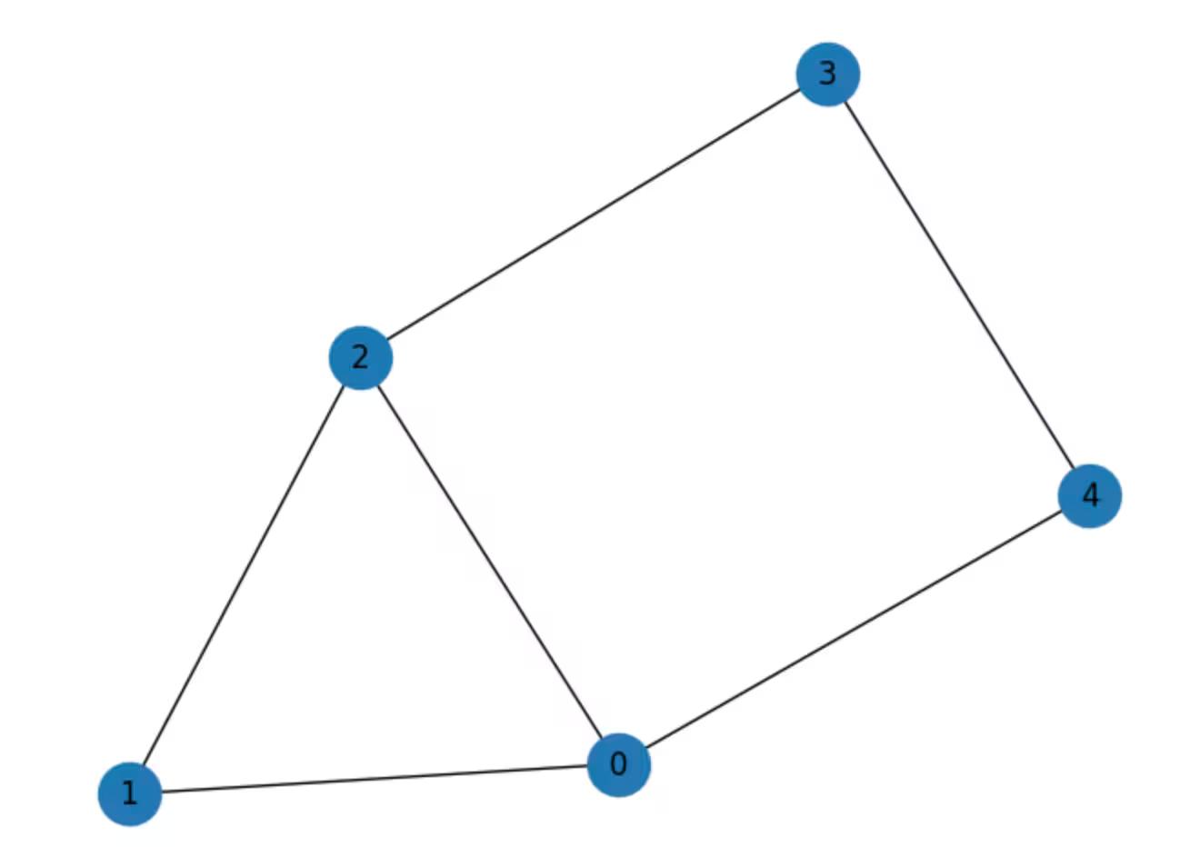

The first step is to create our graph by defining the number of nodes and the edges that connect two nodes. You can do this by importing a package called rustworkx, as demonstrated in the tutorial. The result will be a graph that looks like this:
Output of Rustworkx max-cut graph

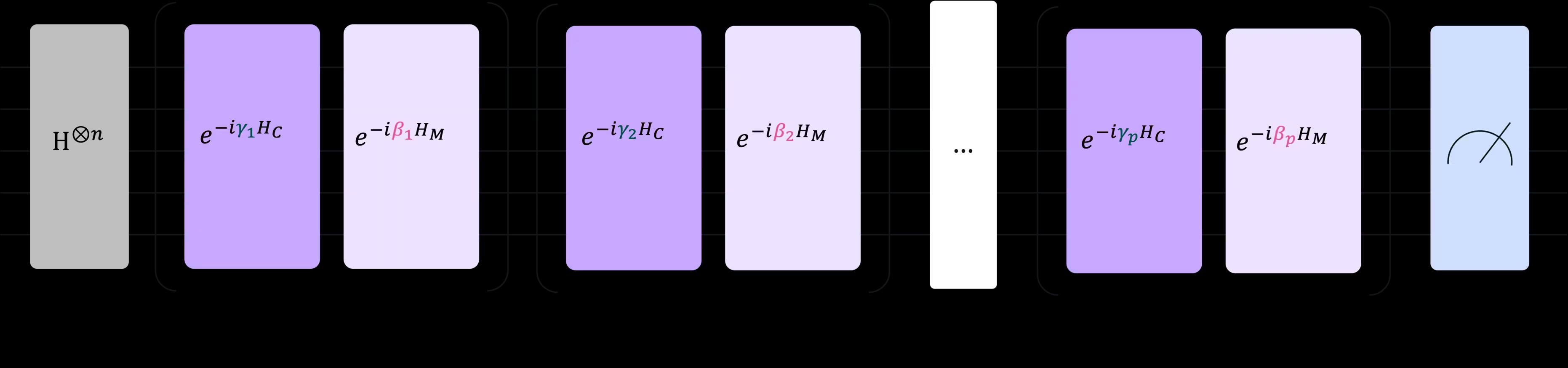

Construct the quantum circuit
With our Hamiltonian written in terms of Pauli operators, we're ready to construct our quantum circuit, which allows us to sample good solutions using a quantum computer:
Circuit diagram with QAOA layers
The QAOA algorithm takes inspiration from the Adiabatic Theorem, which states that if we start in the ground state of a time-dependent Hamiltonian, if the Hamiltonian evolves slowly enough, and given enough time, the final state will be the ground state of the final Hamiltonian. QAOA can be thought of as the discrete, trotterized version of this Quantum Adiabatic Algorithm, where each trotter step represents a layer of the QAOA algorithm. So instead of evolving from one state to the other, in each layer, we will switch back and forth between our cost function Hamiltonian and a so-called “mixer” Hamiltonian, which we'll cover later in this lesson.
The advantage of QAOA is that it's faster than the quantum adiabatic algorithm, but it returns approximate solutions rather than the optimal. In the limit where the number of layers goes to infinity, QAOA converges to the QAA case, but of course this is very computationally expensive.
To create our quantum circuit, we'll apply alternating operators, parameterized by γ\gamma and β\beta, which will represent the discretization of the time evolution.
So, the three main parts of the QAOA circuit are:
  1. the initial trial state, in grey, which is the ground state of the mixer, created by applying a Hadamard gate applied to every qubit
  2. the cost function evolution, which we've discussed previously, in dark purple
  3. the evolution under the mixer Hamiltonian, which we have not yet covered, in light purple.
Our starting Hamiltonian is called the Mixer because its ground state is the superposition of all possible bitstrings of interest: hence enforcing a mixture of all possible solutions at the start.
The mixer Hamiltonian is the simple, sum of Pauli-X operations on each node of the graph. Qiskit allows you to use a different, custom mixer operator if you wish, but we are going to use the standard one here. So again, you can see that with Qiskit, a lot of the work is removed for us, making coming up with the mixer Hamiltonian and the starting state trivial. The only work we had to do was to find the cost function.
Each iteration of these operators is called a layer. These layers can be seen as discretization of the time evolution of the system, as previously described. The alternating pattern comes from the trotter decomposition and approximates the exponential functions of non-commuting matrices. In general, the more layers or steps we include, the closer we will be to continuous time evolution, like in QAA, so in theory, the more accurate the result will be. But for this example, we'll begin by just sampling with one layer. Remember, both the cost function Hamiltonian and the mixer are parameterized, we still need to come up with optimal values for γ\gamma and β\beta.

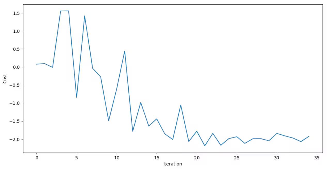

Back to the optimization problem. We need to find better values of gamma and beta than just our rough first guesses. We will do this by plugging in our cost function and these initial guesses into a scipy optimizer COBYLA.
COBYLA optimization graph
Here you can see the value of the cost function over the iterations. It starts off a little wonky and goes up and down, but then settles to a low value. We will use the values that scipy found that correspond to the lowest evaluation of the cost function.
Now that we were able to reduce our cost function by finding better values of our parameters, we will run our circuit using the new values we found for gamma and beta. I listed the specific values that I am using here, but remember, when you try your hand at this or even just rerun the same tutorial notebook, these values might change slightly. Now we will run our optimized circuit with these values and find our candidate solution to our max-cut problem.

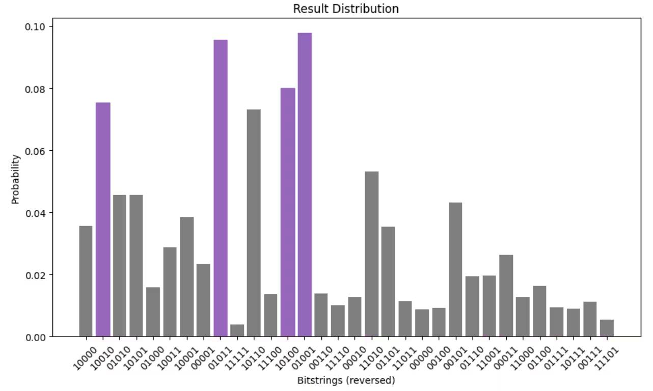

Now let's plot a histogram of the data to look at the final solution:
Max-cut solution histogram
The bit strings represent how each of the nodes were partitioned into two groups (labelled “0” and “1”) by the cut. There should be four solutions that all give the maximum value of edges cut. These four are shown in purple. You can see right away that 4 solutions are much more probable than any of the others. The highest, and thus most probable bit string solution is 0,1,0,1,1. (Remember – the order of the qubits is reversed in the plot bitstrings!)

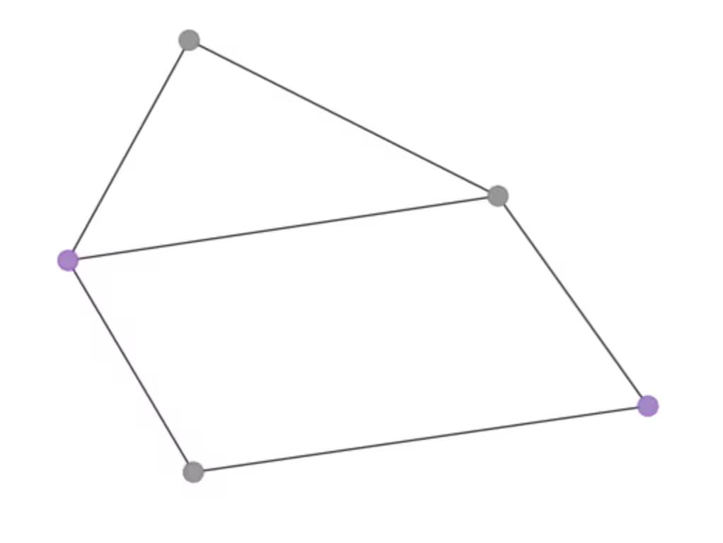

From this plot, we can take the most likely bitstring and represent it as a partitioned graph, with the cut going through five edges:
Max-cut solution
So, this is indeed a max-cut solution. But it's not the only one! Because of the symmetry of this graph, there are multiple correct solutions. Instead of having the nodes 0 and 3 be inside the cut, we could have nodes 2 and 4 be included. You can see that all I had to do was rotate my cut to include these new points. The number of edges cut remains five. There turns out to be four max cut solutions, since each of the two solutions we noted also has an “opposite” partner, where the purple nodes are grey and the grey nodes are purple – so the cut remains the same, but each node effectively swaps to the opposite side of the partition.
Let's look again at the histogram and the four most likely solutions for a minute. Ideally, they would be each of the four true max-cut solutions. The problem is that the algorithm actually didn't identify the fourth and final solution as being one of the top 4 most probable answers. It was the fifth most likely. The fourth solution that the algorithm identified is incorrect--if you were to draw it, you would see that the solution only has four cuts.
But remember: this is an approximate algorithm. It is not infallible, and it is not correct 100% of the time. You do have to employ some of your own knowledge and understanding to sanity-check the solutions.
This error can arise from several places:
  1. It could be the approximate nature of the algorithm itself, and the small number of layers I employed.
  2. It could be a finite sampling error, this could be reduced if I increase the number of shots in my experiment.
  3. It could also be a readout error, since the fourth real solution is only off by one bit.
This kind of error analysis is what it takes to become a practitioner of quantum computing. You need to understand the performance of the hardware and how this can contribute to certain types of errors and how to correct for them.
However, let's not forget that there were 32 possible bit strings, and that the four real solutions were included in the top five best candidates. And we only used two layers to find this. In general, if we wanted to increase our chances of finding the best max-cut every time, we could increase the layer depth. There are some subtleties to this, but that's for a later lesson.
