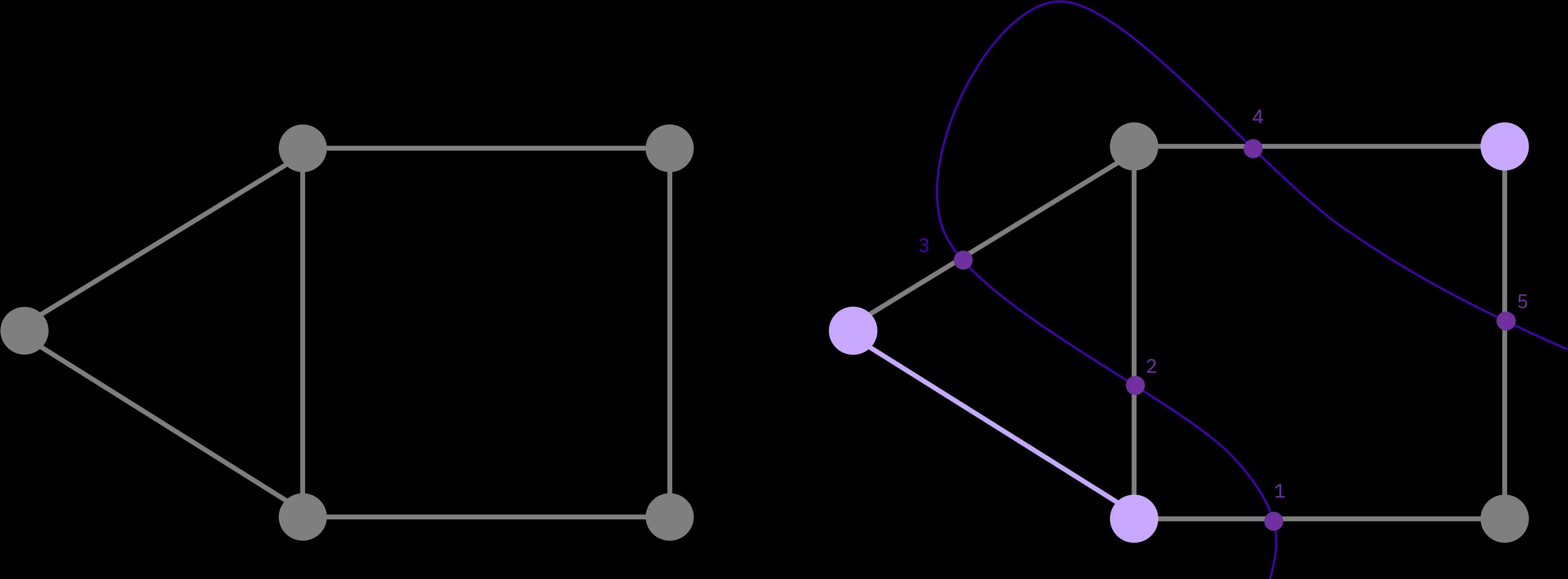

The max-cut problem is an optimization problem that is hard to solve (more specifically, it is an NP-hard problem) with a number of different applications in clustering, network science, and statistical physics. This tutorial considers a graph of nodes connected by edges and aims to partition the nodes into two sets by "cutting" edges, such that the number of edges cut is maximized.
"Maxcut"
To give some context before mapping this problem to a quantum algorithm, you can better understand how the max-cut problem becomes a classical combinatorial optimization problem by first considering the minimization of a function f(x)f(x)

Initialize your problem by creating a graph with n=5n=5 nodes.
import matplotlib
import numpy as np
import rustworkx as rx
from rustworkx.visualization import mpl_draw
n = 5
graph = rx.PyGraph()
graph.add_nodes_from(range(1, n + 1))
edge_list = [
    (0, 1, 1.0),
    (0, 2, 1.0),
    (1, 2, 1.0),
    (1, 3, 1.0),
    (2, 4, 1.0),
    (3, 4, 1.0),
graph.add_edges_from(edge_list)
pos = rx.spring_layout(graph, seed=2)
mpl_draw(graph, node_size=600, pos=pos, with_labels=True, labels=str)

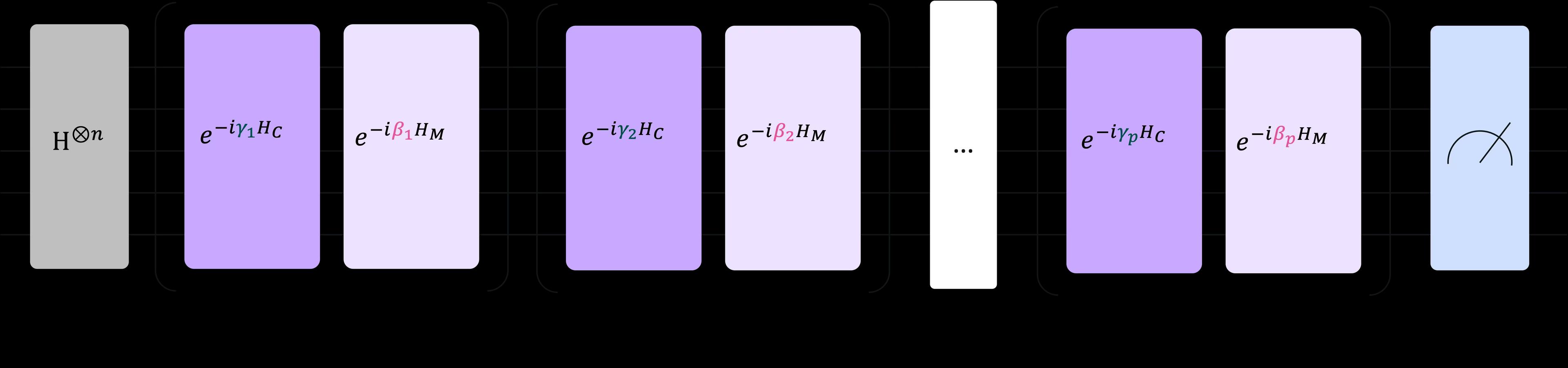

The general idea is to start in the ground state of a known system, H⊗n∣0⟩H^{\otimes n}|0\rangle above, and then steer the system into the ground state of the cost operator that you are interested in. This is done by applying the operators exp⁡{−iγkHC}\exp\{-i\gamma_k H_C\} and exp⁡{−iβkHm}\exp\{-i\beta_k H_m\} with angles γ1,...,γp\gamma_1,...,\gamma_p and β1,...,βp \beta_1,...,\beta_p~.
The quantum circuit that you generate is parametrized by γi\gamma_i and βi\beta_i, so you can try out different values of γi\gamma_i and βi\beta_i and sample from the resulting state.
"QAOA circuit diagram"

Visualize best cut
From the optimal bit string, you can then visualize this cut on the original graph.
colors = ["tab:grey" if i == 0 else "tab:purple" for i in most_likely_bitstring]
mpl_draw(graph, node_size=600, pos=pos, with_labels=True, labels=str, node_color=colors)
Output:
Output of the previous code cell
And calculate the value of the cut. The solution is not optimal due to noise (the cut value of the optimal solution is 5).
from typing import Sequence
def evaluate_sample(x: Sequence[int], graph: rx.PyGraph) -> float:
    assert len(x) == len(
        list(graph.nodes())
    ), "The length of x must coincide with the number of nodes in the graph."
    return sum(
        x[u] * (1 - x[v]) + x[v] * (1 - x[u]) for u, v in list(graph.edge_list())
cut_value = evaluate_sample(most_likely_bitstring, graph)
print("The value of the cut is:", cut_value)
Output:
The value of the cut is: 5
