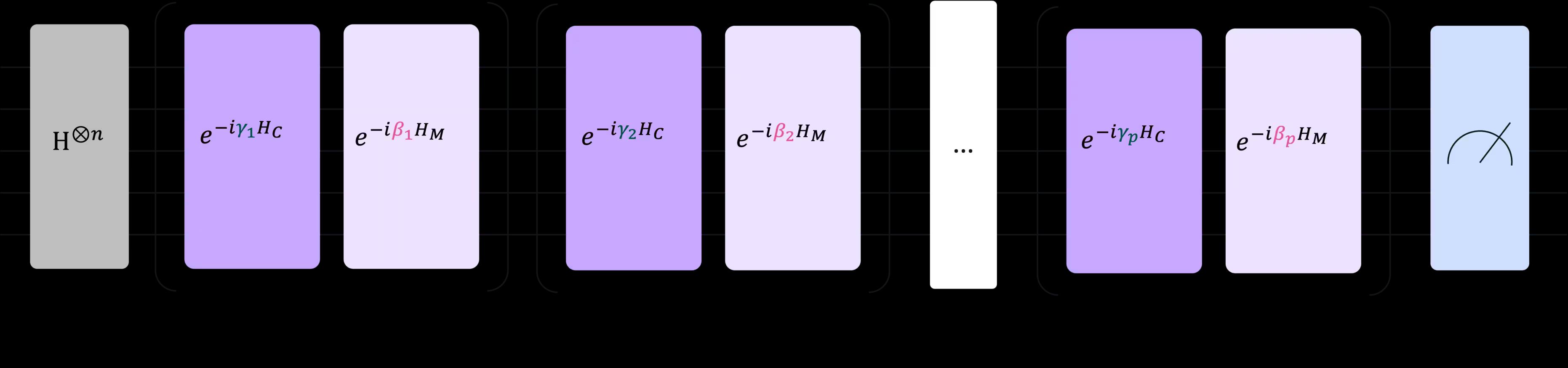

How QAOA works
QAOA prepares candidate solutions by applying alternating layers of two operators to an initial superposition state H⊗n∣0⟩H^{\otimes n}|0\rangle: the cost operator e−iγkHCe^{-i\gamma_k H_C} and a mixer operator e−iβkHme^{-i\beta_k H_m}. The angles γk\gamma_k and βk\beta_k are optimized in a classical feedback loop; the quantum computer evaluates the cost function, and a classical optimizer updates the parameters until convergence. This iterative loop runs within a Quantum Compute session, which keeps the quantum device reserved across iterations for lower latency.
Circuit diagram with QAOA layers
For a deeper treatment of QAOA theory, including the full QUBO-to-Hamiltonian derivation, see the QAOA course module.

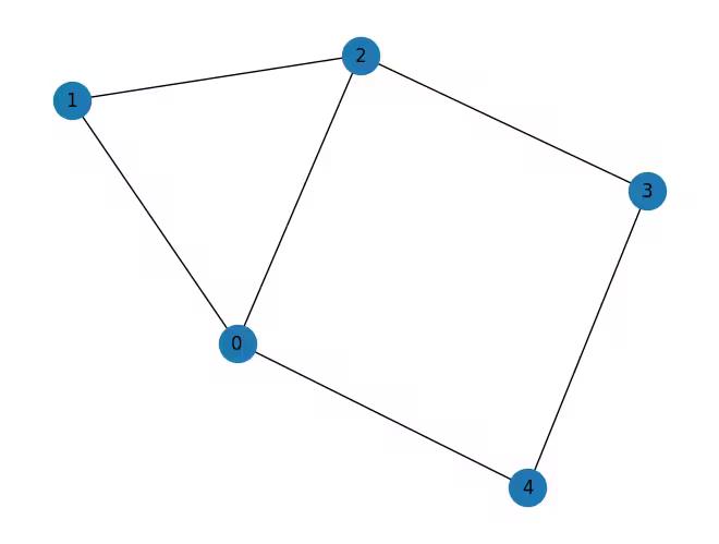

This section walks through each step of the QAOA workflow on a small five-node max-cut instance. Despite the "small-scale" label, this example still runs on real IBM Quantum hardware — the code selects a backend with 127 or more qubits and executes the circuit there.
Initialize your problem by creating a graph with n=5n=5 nodes.
n_small = 5
graph = rx.PyGraph()
graph.add_nodes_from(np.arange(0, n_small, 1))
edge_list = [
    (0, 1, 1.0),
    (0, 2, 1.0),
    (0, 4, 1.0),
    (1, 2, 1.0),
    (2, 3, 1.0),
    (3, 4, 1.0),
graph.add_edges_from(edge_list)
draw_graph(graph, node_size=600, with_labels=True)

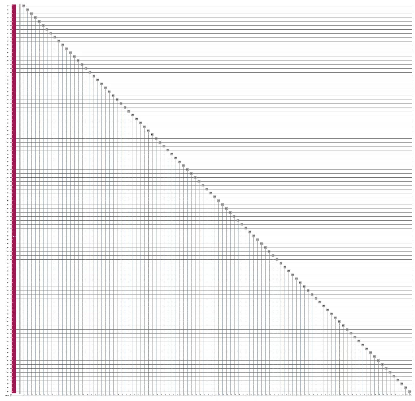

Build the QAOA ansatz circuit
Use QAOAAnsatz to construct the parametrized QAOA circuit from the cost Hamiltonian. Here we use reps=2 (two QAOA layers, four parameters: β0,β1,γ0,γ1\beta_0, \beta_1, \gamma_0, \gamma_1).
circuit = QAOAAnsatz(cost_operator=cost_hamiltonian, reps=2)
circuit.measure_all()
circuit.draw("mpl")

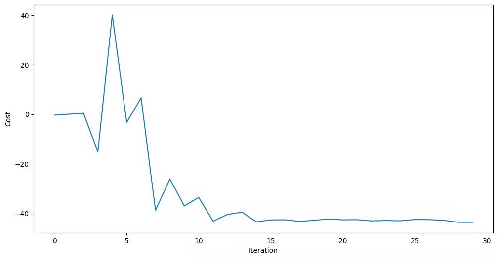

The optimizer was able to reduce the cost and find better parameters for the circuit.
A smoothly decreasing curve that plateaus is the signature of convergence. A noisy, non-monotonic curve usually indicates that something upstream needs attention; common causes are too few shots per evaluation (high estimator variance), poor initial parameters, or a circuit whose depth is dominated by hardware noise. COBYLA is derivative-free and fairly robust to moderate noise, but when the noise swamps the actual cost improvements per step, its linear-approximation model can no longer tell real descent from random jitter and the optimizer wanders.
plt.figure(figsize=(12, 6))
plt.plot(objective_func_vals)
plt.xlabel("Iteration")
plt.ylabel("Cost")
plt.show()

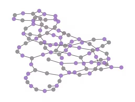

Visualize best cut
From the optimal bitstring, you can then visualize this cut on the original graph.
# auxiliary function to plot graphs
def plot_result(G, x):
    colors = ["tab:grey" if i == 0 else "tab:purple" for i in x]
    pos, _default_axes = rx.spring_layout(G), plt.axes(frameon=True)
    rx.visualization.mpl_draw(
        G, node_color=colors, node_size=100, alpha=0.8, pos=pos
plot_result(graph, most_likely_bitstring)
Output:
Output of the previous code cell
Now, calculate the value of the cut. The objective of the OptimizationProblem is the cut value itself, so evaluate it directly on the bitstring. You can also compare it with the cut value implied by the optimizer's final cost, −(⟨HC⟩+offset)-(\langle H_C \rangle + \text{offset}), which is an average over the whole sampled distribution rather than the value of a single bitstring.
cut_value = maxcut_problem.objective.evaluate(np.array(most_likely_bitstring))
print("The value of the cut is:", cut_value)
print("Cut value implied by the optimized cost:", -(result.fun + offset))
Output:
The value of the cut is: 5.0
Cut value implied by the optimized cost: 4.016422532383906

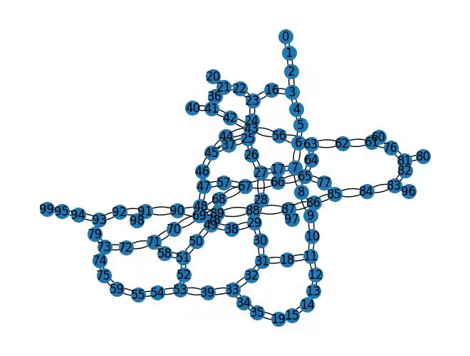

Step 1: Build the graph from the backend's coupling map, then map it to the cost Hamiltonian with the Optimization Mapper addon and build the ansatz.
# Step 1: build the 100-node graph, cost Hamiltonian, and QAOA ansatz.
n_large = 100
graph_100 = rx.PyGraph()
graph_100.add_nodes_from(np.arange(0, n_large, 1))
elist = set()
for u, v in backend.coupling_map:
    # The coupling map lists both directions of each coupler, so sort
    # the endpoints to avoid adding the same edge twice.
    if u < n_large and v < n_large:
        elist.add((min(u, v), max(u, v), 1.0))
graph_100.add_edges_from(sorted(elist))
maxcut_100 = Maxcut(graph_100)
maxcut_problem_100 = maxcut_100.to_optimization_problem()
qubo_100 = OptimizationProblemToQubo().convert(maxcut_problem_100)
cost_hamiltonian_100, offset_100 = to_ising(qubo_100)
circuit_100 = QAOAAnsatz(cost_operator=cost_hamiltonian_100, reps=1)
circuit_100.measure_all()

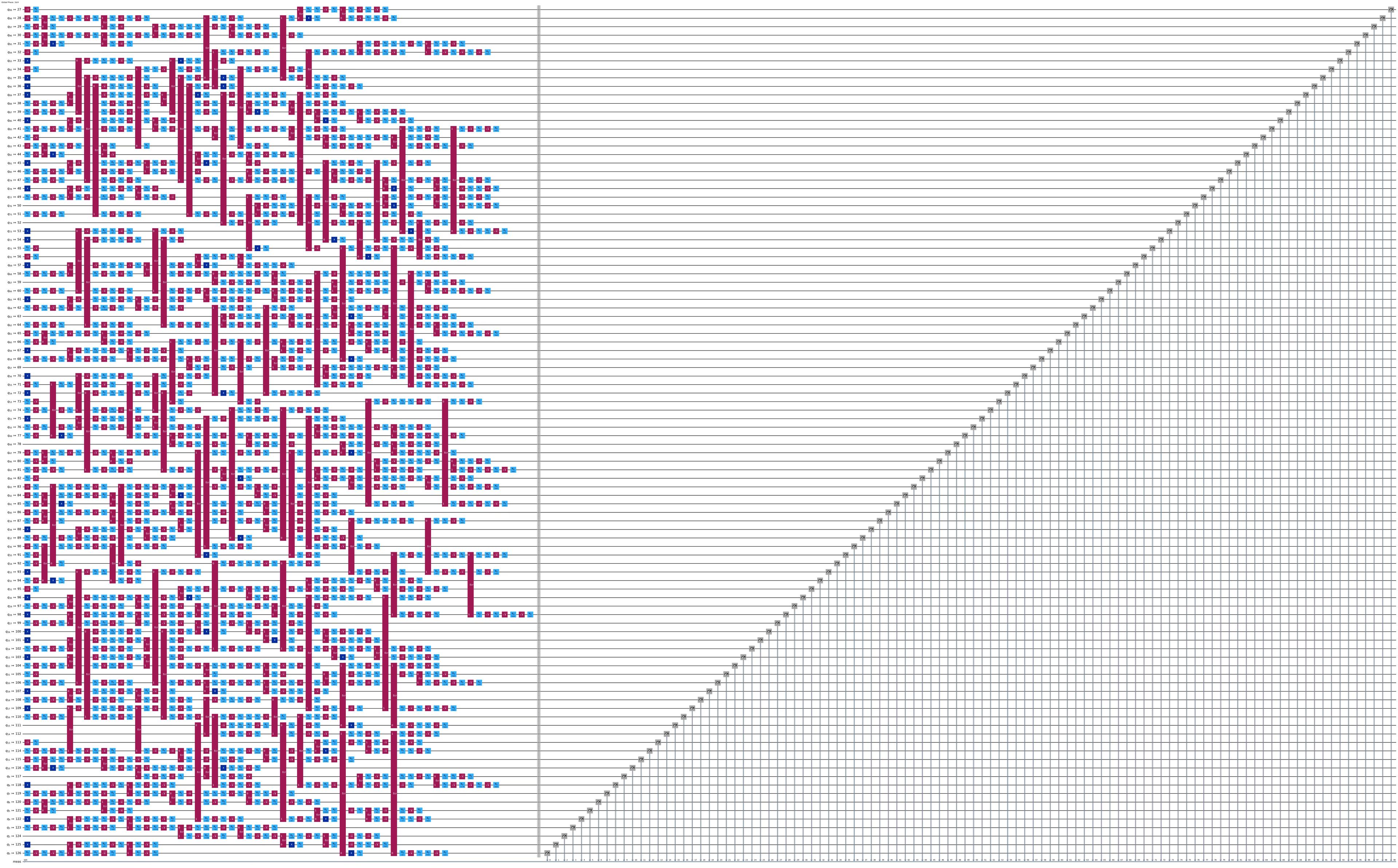

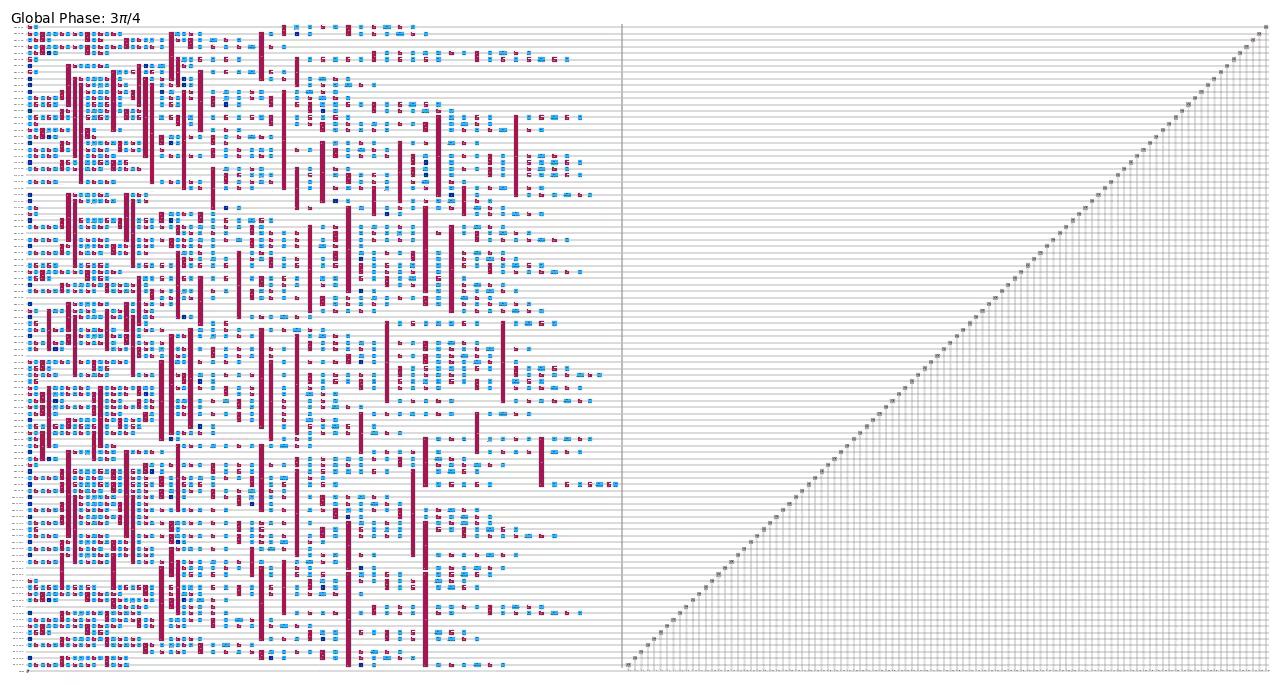

Step 2: Transpile for the selected hardware backend.
# Step 2: transpile for hardware.
pm = generate_preset_pass_manager(optimization_level=3, backend=backend)
candidate_circuit_100 = pm.run(circuit_100)

Check that the cost minimized in the optimization loop has converged, and visualize results.
# Plot convergence
plt.ylabel("Cost")
plt.show()
# Visualize the cut
plot_result(graph_100, best_sol_bitstring_100)
