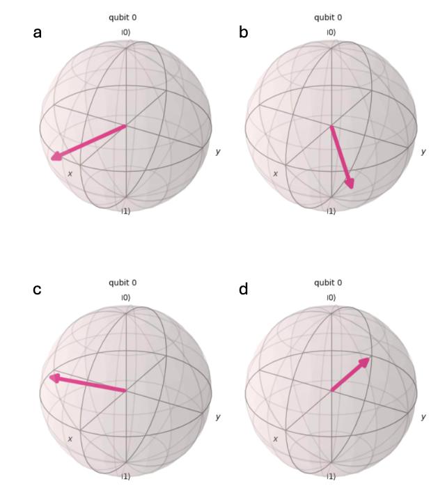

  1. Select the correct Bloch vector that represents the state Ψ=130+eiπ/4231|\Psi\rangle = \sqrt{\frac{1}{3}}|0\rangle + e^{i \pi / 4} \sqrt{\frac{2}{3}}|1\rangle :
Four Bloch spheres are shown. The vector points nearly along +x in option a, halfway between +x and +y and slightly below the xy plane in option b, between +x and -y, and slightly above the xy plane in option c, and along -x in option d.
