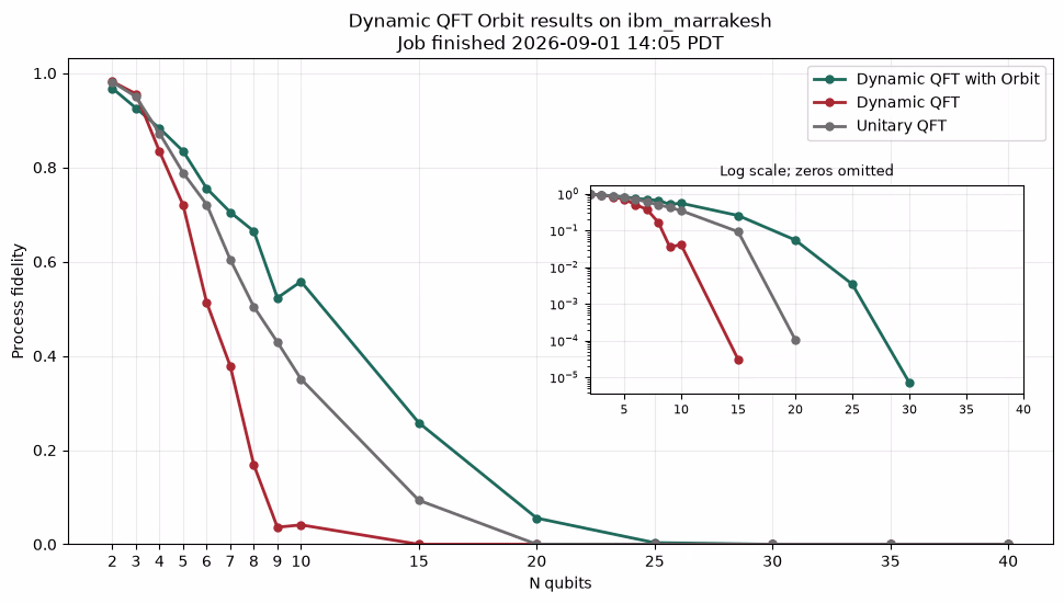

Figure 2a of Ref. [1] benchmarks the process fidelity of the ideal QFT+M channel against noisy unitary and dynamic implementations. For a sampled computational-basis label xx, the benchmark prepares QFT†∣x⟩\mathrm{QFT}^\dagger|x\rangle, applies the noisy QFT+M implementation, and estimates the probability pxp_x of obtaining the corresponding ideal output. These inverse-QFT states are separable and can be prepared efficiently with Hadamard gates and virtual phase rotations.
For mm independently sampled labels, the notebook uses the unbiased estimator derived in Ref. [1]:
F^proc=mm−1(1m∑ℓ=1mpxℓ)2−1m(m−1)∑ℓ=1mpxℓ.\widehat{\mathcal{F}}_{\mathrm{proc}} = \frac{m}{m-1}\left(\frac{1}{m}\sum_{\ell=1}^{m}\sqrt{p_{x_\ell}}\right)^2 - \frac{1}{m(m-1)}\sum_{\ell=1}^{m}p_{x_\ell}.
The dynamic construction replaces the controlled-phase gates of unitary QFT+M with mid-circuit measurements and classically conditioned phase rotations [1]. By deferred measurement, both circuits have the same ideal output distribution. The unitary implementation requires all-to-all two-qubit-gates, and due to local connectivity constraints, incurs an O(n2)O(n^2) SWAP gate overhead. In contrast, the dynamic circuit uses only single qubit gates and O(n)O(n) mid-circuit measurements that introduce long idles in the middle. Disregarding DD entirely, the basic competition is thus between O(n2)O(n^2) noisy unitary gates and O(n)O(n) noisy mid-circuit measurements. Provided that idles during these mid-circuit measurements are low enough error, the dynamic circuit will outperform unitary implementations, and we show this can be achieved using Orbit below.
Relation to Figure 2a. This notebook follows the paper's sampled process-fidelity protocol, but it is an Orbit-focused tutorial adaptation rather than a reproduction. For example, whereas Figure 2a used ibm_kyiv with 2000 shots, we use a modern device ibm_aachen with a smaller 1024-shot count to preserve QPU time.
Example results
The static plot below shows the mean process-fidelity curves from three back-to-back development jobs run on ibm_aachen with the process described below. As demonstrated here, Orbit can greatly increase the quality of dynamic circuits; dynamic QFT matches published benchmark quality and shows an improvement over standard unitary QFT. As we shall see, these results comes from an automated good choice of qubits, automatic dynamic decoupling insertion (not hand-optimized to this problem), and measurement error mitigation. For fun, make sure to compare these results to your results at the end, especially if you choose a different backend.
Note: These results are an illustrative snapshot of a successful earlier run with Orbit, not a performance guarantee. Results below should look qualitatively similar, but the specifics depend on the device chosen and its properties, especially measurement and idling errors, at runtime.
QFT process fidelity on 'ibm_aachen'

Run the benchmark
Pass the JSON-serializable Batch configuration through orbit.run(...). Orbit creates the authenticated Runtime Batch inside the Function, submits the ordered PUB partitions, closes the Batch after submission, and returns one merged result to the caller. A caller-created local Batch cannot control an asynchronous Qiskit Function job.
The ordered PUB list is partitioned by qubit-count groups so that all three strategies for a fixed NN can be compared fairly: all 60 PUBs for a fixed NN — 20 sampled inputs times the three strategies — execute in the same Runtime Batch child job. The default groups combine large and small circuits and contain 300 PUBs each, reducing the chance that one child job accumulates all of the largest dynamic programs while preserving within-job comparisons.
job = quantum_elements_orbit.run(
    primitive="sampler",
    pubs=pubs,
    backend_name=backend.name,
    options={
        "pub_options": pub_options,
        "batch": {
            "max_pubs_per_job": BATCH_MAX_PUBS_PER_JOB,
            "max_time": "2h",
        "save_backend_info": True,
    "backend": backend.name,
    "function_job_id": job.job_id,
    "status": job.status(),
    "num_pubs": len(pubs),
    "max_pubs_per_runtime_job": BATCH_MAX_PUBS_PER_JOB,
    "n_groups": N_GROUPS,
Output:
{'backend': 'ibm_marrakesh',
 'function_job_id': '4b953302-afc3-4889-9ecf-e63d78b4e252',
 'status': 'QUEUED',
 'num_pubs': 900,
 'max_pubs_per_runtime_job': 300,
 'n_groups': [[40, 2, 7, 15, 10], [35, 3, 6, 20, 9], [30, 4, 5, 25, 8]]}
Retrieve results and compute process fidelity
Retrieve the single merged result returned by the Orbit Function. Orbit records the Runtime Batch ID, child Runtime job IDs, and PUB ranges in the result metadata; the PUB order is preserved across child jobs. For each PUB, pxp_x is the probability assigned to the expected bitstring. extract_counts reads the counts returned to the caller; for dynamic/orbit, these are the MEM-adjusted counts when mitigation succeeds. extract_raw_counts also recovers the corresponding unmitigated counts recorded in Orbit metadata. The code groups the 20 values of pxp_x for each (N, label) pair and applies the estimator introduced above.
The plotted process_fidelity dictionary therefore uses raw counts for unitary/raw and dynamic/raw, but MEM-adjusted counts for dynamic/orbit. The parallel raw_process_fidelity dictionary retains an unmitigated calculation for every strategy and is useful when separating the effect of MEM from the rest of the Orbit pipeline. MEM corrects the returned output histogram; it cannot retroactively change a mid-circuit measurement result that was already used by real-time feedforward.

Plot process-fidelity curves
The plot shows the sampled QFT process-fidelity point estimate versus qubit count for the three strategies. dynamic/raw and dynamic/orbit share a physical layout at each size; unitary/raw uses the transpiler's layout and routing.
Unlike Figure 2a, this plot does not show a unitary-with-DD curve or uncertainty bands, and its raw curves are not readout-mitigated. It is best read as a Figure-2a-style scaling comparison for this Orbit workflow, not as a direct reproduction of the published curves.
from datetime import datetime
from zoneinfo import ZoneInfo
finished_local = datetime.now(ZoneInfo("America/Los_Angeles"))
labels = ["dynamic/orbit", "dynamic/raw", "unitary/raw"]
colors = {
    "dynamic/orbit": "#26735b",
    "dynamic/raw": "#9b1c31",
    "unitary/raw": "#6e6e6e",
pretty_labels = {
    "dynamic/orbit": "Dynamic QFT with Orbit",
    "dynamic/raw": "Dynamic QFT",
    "unitary/raw": "Unitary QFT",
series = []
for label in labels:
    values = [process_fidelity[str(n)][label] for n in N_VALUES]
    log_values = [value if value > 0.0 else float("nan") for value in values]
    series.append((label, values, log_values))
nonzero_values = [
    value
    for _, _, log_values in series
    for value in log_values
    if value > 0.0
if not nonzero_values:
    raise RuntimeError(
        "No nonzero process-fidelity values found for log inset"
log_floor = min(nonzero_values) / 2
fig, ax = plt.subplots(figsize=(9.8, 5.6))
for label, values, _ in series:
    ax.plot(
        N_VALUES,
        values,
        marker="o",
        linewidth=2.0,
        markersize=5,
        color=colors[label],
        label=pretty_labels[label],
ax.set_xlabel("N qubits")
ax.set_ylabel("Process fidelity")
finished_time_for_title = finished_local
ax.set_title(
    f"Dynamic QFT Orbit results on {IBM_BACKEND_NAME}\n"
    f"Job finished {finished_time_for_title:%Y-%m-%d %H:%M %Z}"
ax.set_xticks(N_VALUES)
ax.set_ylim(bottom=0)
ax.grid(axis="both", alpha=0.25)
ax.legend(loc="upper right")
inset = ax.inset_axes([0.53, 0.31, 0.44, 0.43])
for label, _, log_values in series:
    inset.plot(
        N_VALUES,
        log_values,
        marker="o",
        linewidth=2.0,
        markersize=5,
inset.set_yscale("log")
inset.set_ylim(bottom=log_floor)
inset.set_xlim(min(N_VALUES), max(N_VALUES))
inset.set_title("Log scale; zeros omitted", fontsize=9)
inset.grid(axis="both", alpha=0.25)
inset.tick_params(axis="both", labelsize=8)
inset.patch.set_alpha(0.96)
fig.tight_layout()
plt.show()
Output:
Output of the previous code cell
