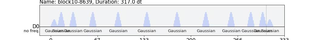

Pulse Builder
Use the pulse builder DSL to write pulse programs with an imperative syntax.
Warning
The pulse builder interface is still in active development. It may have breaking API changes without deprecation warnings in future releases until otherwise indicated.
The pulse builder provides an imperative API for writing pulse programs with less difficulty than the Schedule API. It contextually constructs a pulse schedule and then emits the schedule for execution. For example, to play a series of pulses on channels is as simple as:

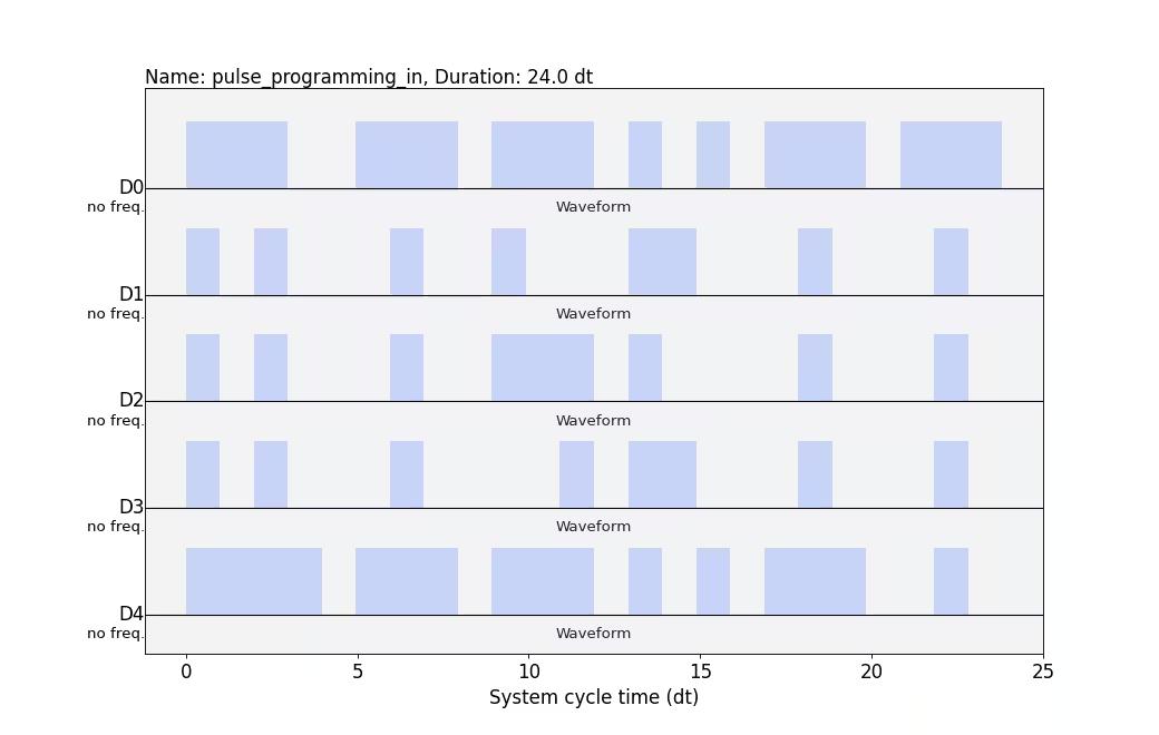

from qiskit import pulse
dc = pulse.DriveChannel
d0, d1, d2, d3, d4 = dc(0), dc(1), dc(2), dc(3), dc(4)
with pulse.build(name='pulse_programming_in') as pulse_prog:
    pulse.play([1, 1, 1, 0, 0, 1, 1, 1, 0, 1, 1, 1, 0, 1, 0, 1, 0, 1, 1, 1, 0, 1, 1, 1], d0)
    pulse.play([1, 0, 1, 0, 0, 0, 1, 0, 0, 1, 0, 0, 0, 1, 1, 0, 0, 0, 1, 0, 0, 0, 1, 0], d1)
    pulse.play([1, 0, 1, 0, 0, 0, 1, 0, 0, 1, 1, 1, 0, 1, 0, 0, 0, 0, 1, 0, 0, 0, 1, 0], d2)
    pulse.play([1, 0, 1, 0, 0, 0, 1, 0, 0, 0, 0, 1, 0, 1, 1, 0, 0, 0, 1, 0, 0, 0, 1, 0], d3)
    pulse.play([1, 1, 1, 1, 0, 1, 1, 1, 0, 1, 1, 1, 0, 1, 0, 1, 0, 1, 1, 1, 0, 0, 1, 0], d4)
pulse_prog.draw()
Output from the previous code.

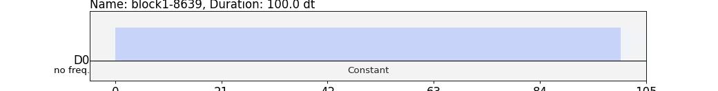

d0 = pulse.DriveChannel(0)
with pulse.build() as pulse_prog:
    pulse.play(pulse.Constant(100, 1.0), d0)
pulse_prog.draw()
The builder initializes a pulse.Schedule, pulse_prog and then begins to construct the program within the context. The output pulse schedule will survive after the context is exited and can be used like a normal Qiskit schedule.

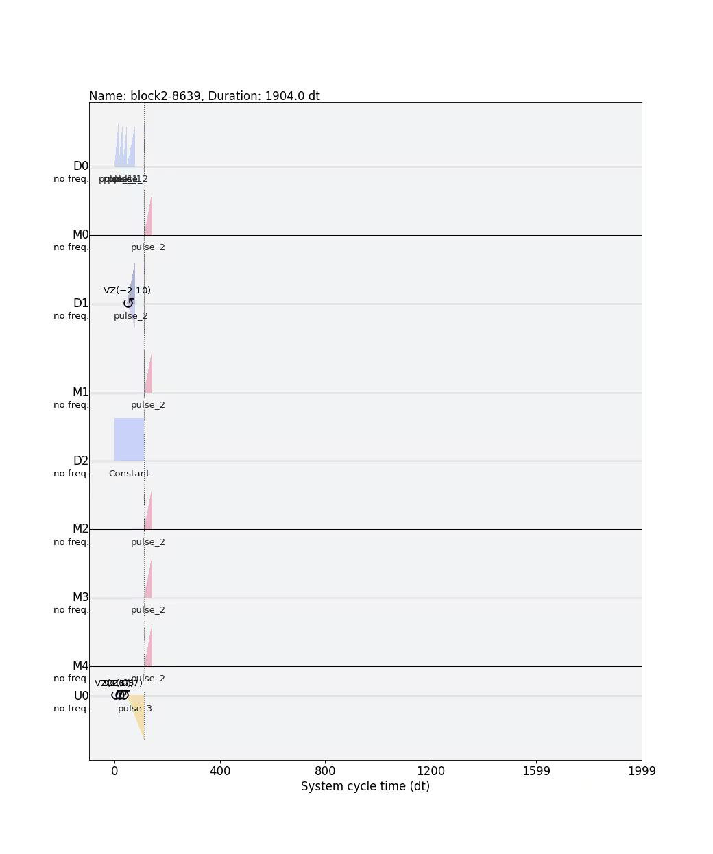

with pulse.build(backend) as decoupled_bell_prep_and_measure:
    # We call our bell state preparation schedule constructed above.
    with pulse.align_right():
        pulse.call(bell_sched)
        pulse.play(pulse.Constant(bell_sched.duration, 0.02), d2)
        pulse.barrier(0, 1, 2)
        registers = pulse.measure_all()
decoupled_bell_prep_and_measure.draw()

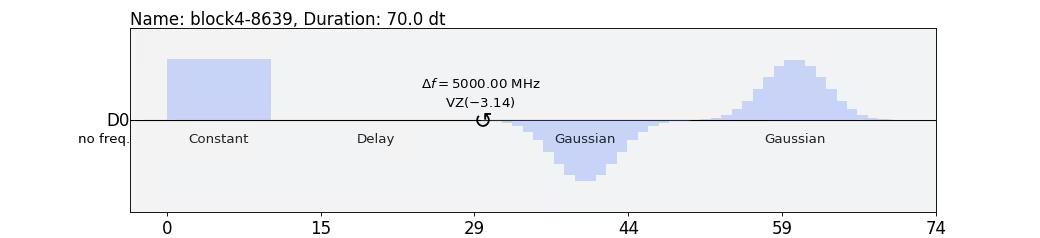

Pulse instructions are available within the builder interface. Here’s an example:
from qiskit.providers.fake_provider import GenericBackendV2
backend = GenericBackendV2(num_qubits=2, calibrate_instructions=True)
with pulse.build(backend) as drive_sched:
    d0 = pulse.drive_channel(0)
    a0 = pulse.acquire_channel(0)
    pulse.play(pulse.Constant(10, 1.0), d0)
    pulse.delay(20, d0)
    pulse.shift_phase(3.14/2, d0)
    pulse.set_phase(3.14, d0)
    pulse.shift_frequency(1e7, d0)
    pulse.set_frequency(5e9, d0)
    with pulse.build() as temp_sched:
        pulse.play(pulse.Gaussian(20, 1.0, 3.0), d0)
        pulse.play(pulse.Gaussian(20, -1.0, 3.0), d0)
    pulse.call(temp_sched)
    pulse.acquire(30, a0, pulse.MemorySlot(0))
drive_sched.draw()

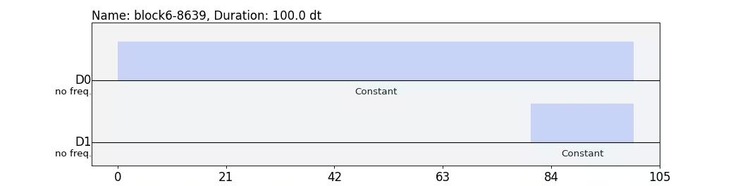

Contexts
Builder aware contexts that modify the construction of a pulse program. For example an alignment context like align_right() may be used to align all pulses as late as possible in a pulse program.
d1 = pulse.DriveChannel(1)
        # this pulse will start at t=0
        # this pulse will start at t=80
        pulse.play(pulse.Constant(20, 1.0), d1)
pulse_prog.draw()

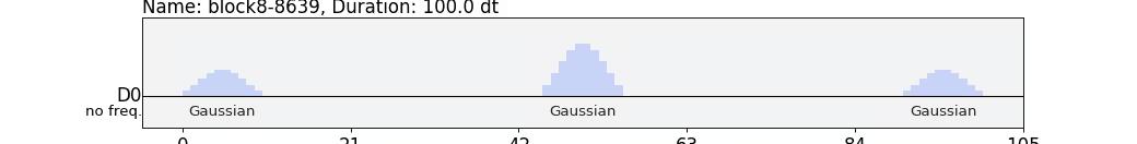

with pulse.build() as hahn_echo:
    with pulse.align_equispaced(duration=100):
        pulse.play(x90, d0)
        pulse.play(x180, d0)
        pulse.play(x90, d0)
hahn_echo.draw()

import numpy as np
x90 = pulse.Gaussian(10, 0.1, 3)
x180 = pulse.Gaussian(10, 0.2, 3)
def udd10_pos(j):
    return np.sin(np.pi*j/(2*10 + 2))**2
with pulse.build() as udd_sched:
    pulse.play(x90, d0)
    with pulse.align_func(duration=300, func=udd10_pos):
        for _ in range(10):
    pulse.play(x90, d0)
udd_sched.draw()

Examples:
pulse_prog = pulse.transforms.block_to_schedule(pulse_prog)
assert pulse_prog.ch_stop_time(d0) == pulse_prog.ch_stop_time(d1)
