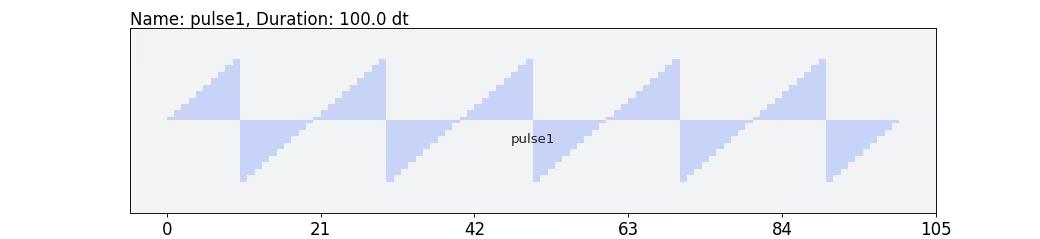

import sympy
from qiskit.pulse.library import SymbolicPulse
t, amp, freq = sympy.symbols("t, amp, freq")
envelope = 2 * amp * (freq * t - sympy.floor(1 / 2 + freq * t))
my_pulse = SymbolicPulse(
pulse_type="Sawtooth",
duration=100,
parameters={"amp": 0.1, "freq": 0.05},
envelope=envelope,
name="pulse1",
my_pulse.draw()
