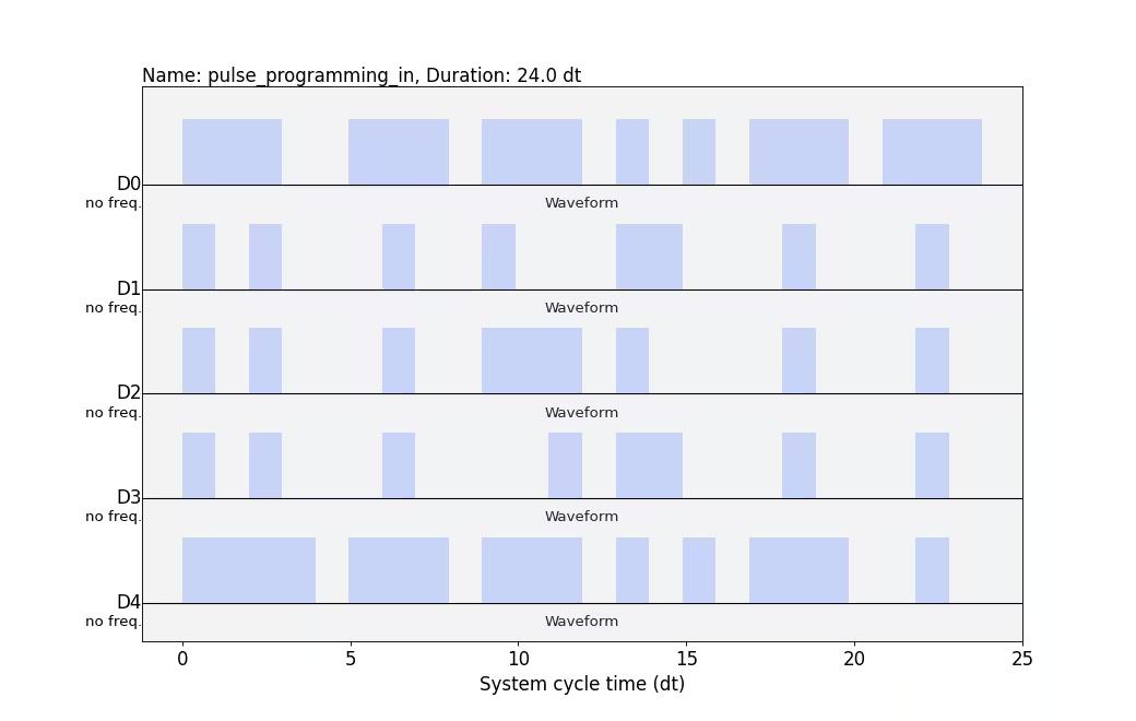

from qiskit import pulse
dc = pulse.DriveChannel
d0, d1, d2, d3, d4 = dc(0), dc(1), dc(2), dc(3), dc(4)
with pulse.build(name='pulse_programming_in') as pulse_prog:
    pulse.play([1, 1, 1, 0, 0, 1, 1, 1, 0, 1, 1, 1, 0, 1, 0, 1, 0, 1, 1, 1, 0, 1, 1, 1], d0)
    pulse.play([1, 0, 1, 0, 0, 0, 1, 0, 0, 1, 0, 0, 0, 1, 1, 0, 0, 0, 1, 0, 0, 0, 1, 0], d1)
    pulse.play([1, 0, 1, 0, 0, 0, 1, 0, 0, 1, 1, 1, 0, 1, 0, 0, 0, 0, 1, 0, 0, 0, 1, 0], d2)
    pulse.play([1, 0, 1, 0, 0, 0, 1, 0, 0, 0, 0, 1, 0, 1, 1, 0, 0, 0, 1, 0, 0, 0, 1, 0], d3)
    pulse.play([1, 1, 1, 1, 0, 1, 1, 1, 0, 1, 1, 1, 0, 1, 0, 1, 0, 1, 1, 1, 0, 0, 1, 0], d4)
pulse_prog.draw()
Output from the previous code.

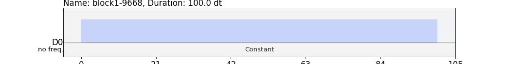

To begin pulse programming we must first initialize our program builder context with build(), after which we can begin adding program statements. For example, below we write a simple program that play()s a pulse:
d0 = pulse.DriveChannel(0)
with pulse.build() as pulse_prog:
    pulse.play(pulse.Constant(100, 1.0), d0)
pulse_prog.draw()
The builder initializes a pulse.Schedule, pulse_prog and then begins to construct the program within the context. The output pulse schedule will survive after the context is exited and can be used like a normal Qiskit schedule.

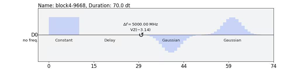

import math
from qiskit.compiler import schedule
from qiskit import pulse, QuantumCircuit
from qiskit.providers.fake_provider import FakeOpenPulse2Q
backend = FakeOpenPulse2Q()
qc = QuantumCircuit(2, 2)
qc.cx(0, 1)
with pulse.build(backend) as pulse_prog:
    # Create a pulse.
    gaussian_pulse = pulse.Gaussian(10, 1.0, 2)
    # Get the qubit's corresponding drive channel from the backend.
    d0 = pulse.drive_channel(0)
    d1 = pulse.drive_channel(1)
    # Play a pulse at t=0.
    pulse.play(gaussian_pulse, d0)
    # Play another pulse directly after the previous pulse at t=10.
    # The default scheduling behavior is to schedule pulses in parallel
    # across channels. For example, the statement below
    # plays the same pulse on a different channel at t=0.
    pulse.play(gaussian_pulse, d1)
    # We also provide pulse scheduling alignment contexts.
    # The default alignment context is align_left.
    # The sequential context schedules pulse instructions sequentially in time.
    # This context starts at t=10 due to earlier pulses above.
    with pulse.align_sequential():
        # Play another pulse after at t=20.
        # We can also nest contexts as each instruction is
        # contained in its local scheduling context.
        # The output of a child context is a context-schedule
        # with the internal instructions timing fixed relative to
        # one another. This is schedule is then called in the parent context.
        # Context starts at t=30.
        with pulse.align_left():
            # Start at t=30.
            # Start at t=30.
        # Context ends at t=40.
        # Alignment context where all pulse instructions are
        # aligned to the right, ie., as late as possible.
        with pulse.align_right():
            # Shift the phase of a pulse channel.
            pulse.shift_phase(math.pi, d1)
            # Starts at t=40.
            pulse.delay(100, d0)
            # Ends at t=140.
            # Starts at t=130.
            # Ends at t=140.
        # Acquire data for a qubit and store in a memory slot.
        pulse.acquire(100, 0, pulse.MemorySlot(0))
        # We also support a variety of macros for common operations.
        # Measure all qubits.
        pulse.measure_all()
        # Delay on some qubits.
        # This requires knowledge of which channels belong to which qubits.
        # delay for 100 cycles on qubits 0 and 1.
        pulse.delay_qubits(100, 0, 1)
        # Call a schedule for a quantum circuit thereby inserting into
        # the pulse schedule.
        qc.cx(0, 1)
        qc_sched = schedule(qc, backend)
        pulse.call(qc_sched)
        # It is also be possible to call a preexisting schedule
        tmp_sched = pulse.Schedule()
        tmp_sched += pulse.Play(gaussian_pulse, d0)
        pulse.call(tmp_sched)
        # We also support:
        # frequency instructions
        pulse.set_frequency(5.0e9, d0)
        # phase instructions
        pulse.shift_phase(0.1, d0)
        # offset contexts
        with pulse.phase_offset(math.pi, d0):
The above is just a small taste of what is possible with the builder. See the rest of the module documentation for more information on its capabilities.

Pulse instructions are available within the builder interface. Here’s an example:
from qiskit.providers.fake_provider import GenericBackendV2
backend = GenericBackendV2(num_qubits=2, calibrate_instructions=True)
with pulse.build(backend) as drive_sched:
    a0 = pulse.acquire_channel(0)
    pulse.play(pulse.Constant(10, 1.0), d0)
    pulse.delay(20, d0)
    pulse.shift_phase(3.14/2, d0)
    pulse.set_phase(3.14, d0)
    pulse.shift_frequency(1e7, d0)
    pulse.set_frequency(5e9, d0)
    with pulse.build() as temp_sched:
        pulse.play(pulse.Gaussian(20, 1.0, 3.0), d0)
        pulse.play(pulse.Gaussian(20, -1.0, 3.0), d0)
    pulse.call(temp_sched)
    pulse.acquire(30, a0, pulse.MemorySlot(0))
drive_sched.draw()

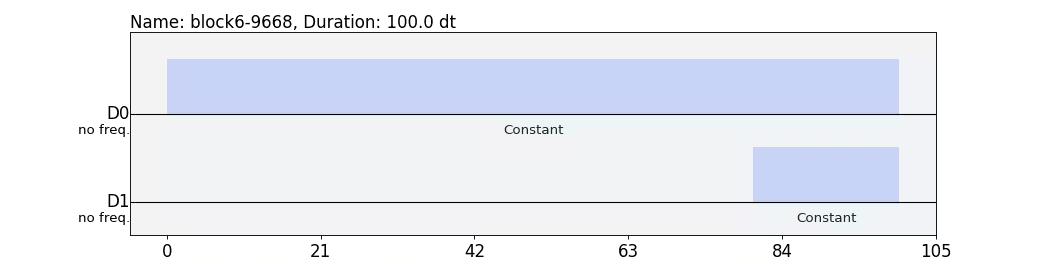

Contexts
Builder aware contexts that modify the construction of a pulse program. For example an alignment context like align_right() may be used to align all pulses as late as possible in a pulse program.
d1 = pulse.DriveChannel(1)
        # this pulse will start at t=0
        # this pulse will start at t=80
        pulse.play(pulse.Constant(20, 1.0), d1)
pulse_prog.draw()

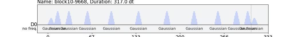

align_func
qiskit.pulse.builder.align_func(duration, func)
GitHub
Callback defined alignment pulse scheduling context.
Pulse instructions within this context are scheduled at the location specified by arbitrary callback function position that takes integer index and returns the associated fractional location within [0, 1]. Delay instruction is automatically inserted in between pulses.
This context may be convenient to write a schedule of arbitrary dynamical decoupling sequences such as Uhrig dynamical decoupling.
Deprecated since version 1.3
The function qiskit.pulse.builder.align_func() is deprecated as of Qiskit 1.3. It will be removed in Qiskit 2.0. The entire Qiskit Pulse package has been deprecated.
Examples:
import numpy as np
x90 = pulse.Gaussian(10, 0.1, 3)
x180 = pulse.Gaussian(10, 0.2, 3)
def udd10_pos(j):
    return np.sin(np.pi*j/(2*10 + 2))**2
with pulse.build() as udd_sched:
    pulse.play(x90, d0)
    with pulse.align_func(duration=300, func=udd10_pos):
        for _ in range(10):
            pulse.play(x180, d0)
    pulse.play(x90, d0)
udd_sched.draw()
Parameters
  • duration (int |ParameterExpression) – Duration of context. This should be larger than the schedule duration.
  • func (Callable[[int], float]) – A function that takes an index of sub-schedule and returns the fractional coordinate of of that sub-schedule. The returned value should be defined within [0, 1]. The pulse index starts from 1.
Yields
None
Return type
Generator[None, None, None]
Notes
The scheduling is performed for sub-schedules within the context rather than channel-wise. If you want to apply the numerical context for each channel, you need to apply the context independently to channels.

align_right
qiskit.pulse.builder.align_right()
GitHub
Right alignment pulse scheduling context.
Pulse instructions within this context are scheduled as late as possible by shifting them right to the latest available time.
The function qiskit.pulse.builder.align_right() is deprecated as of Qiskit 1.3. It will be removed in Qiskit 2.0. The entire Qiskit Pulse package has been deprecated.
Examples:
pulse_prog = pulse.transforms.block_to_schedule(pulse_prog)
assert pulse_prog.ch_stop_time(d0) == pulse_prog.ch_stop_time(d1)
Yields
None
Return type
