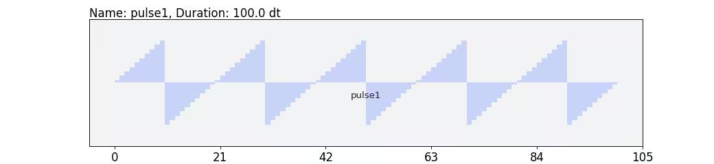

my_pulse.draw()
Output from the previous code.
Likewise, you can define SymbolicPulse.constraints for my_pulse. After providing the envelope definition, you can generate the waveform data. Note that it would be convenient to define a factory function that automatically accomplishes this procedure.
