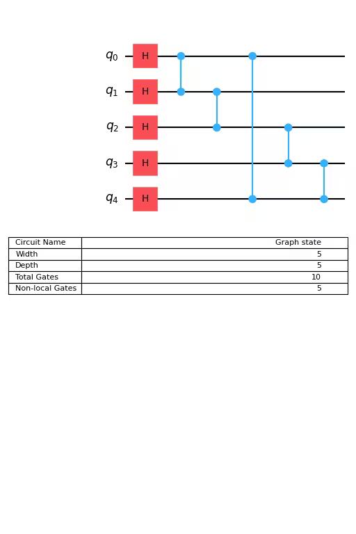

Circuit to prepare a graph state.
Given a graph G = (V, E), with the set of vertices V and the set of edges E, the corresponding graph state is defined as
Such a state can be prepared by first preparing all qubits in the state, then applying a gate for each corresponding graph edge.
Graph state preparation circuits are Clifford circuits, and thus easy to simulate classically. However, by adding a layer of measurements in a product basis at the end, there is evidence that the circuit becomes hard to simulate [2].
Reference Circuit:
