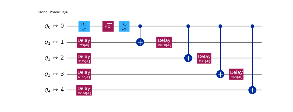

Since the output of generate_preset_pass_manager() is a StagedPassManager, you can also modify the pass manager after its creation to provide an entirely custom stage implementation. For example, if you wanted to run a custom scheduling stage using dynamical decoupling (using the PadDynamicalDecoupling pass) and also add initial logical optimization prior to routing, you would do something like the following (building off the previous example):
import numpy as np
from qiskit.providers.fake_provider import GenericBackendV2
from qiskit.circuit import library as lib
from qiskit.transpiler import PassManager, generate_preset_pass_manager
from qiskit.transpiler.passes import (
    ALAPScheduleAnalysis,
    InverseCancellation,
    PadDynamicalDecoupling,
backend = GenericBackendV2(num_qubits=5)
dd_sequence = [lib.XGate(), lib.XGate()]
scheduling_pm = PassManager(
        ALAPScheduleAnalysis(target=backend.target),
        PadDynamicalDecoupling(target=backend.target, dd_sequence=dd_sequence),
inverse_gate_list = [
    lib.CXGate(),
    lib.HGate(),
    (lib.RXGate(np.pi / 4), lib.RXGate(-np.pi / 4)),
    (lib.PhaseGate(np.pi / 4), lib.PhaseGate(-np.pi / 4)),
    (lib.TGate(), lib.TdgGate()),
logical_opt = PassManager([InverseCancellation(inverse_gate_list)])
pass_manager = generate_preset_pass_manager(optimization_level=0)
# Add pre-layout stage to run extra logical optimization
pass_manager.pre_layout = logical_opt
# Set scheduling stage to custom pass manager
pass_manager.scheduling = scheduling_pm
Now, when the staged pass manager is run via the run() method, the logical_opt pass manager will be called before the layout stage, and the scheduling_pm pass manager will be used for the scheduling stage instead of the default.

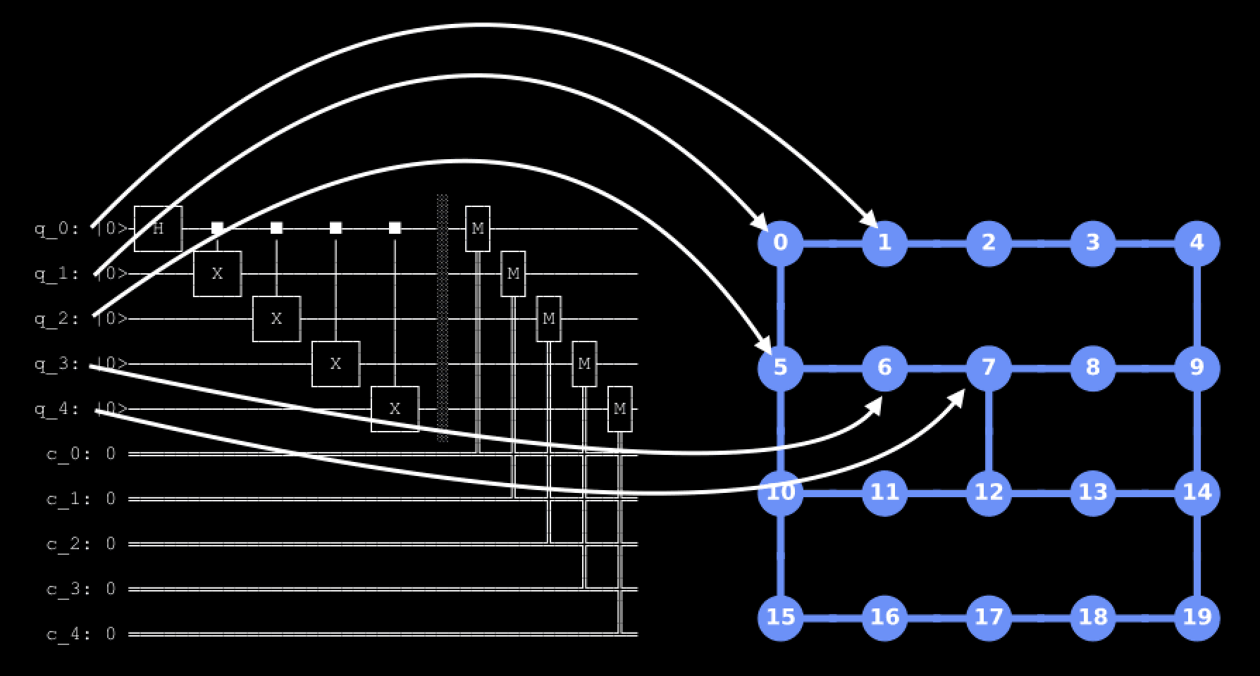

At any given point in a circuit, we can identify a mapping between currently active “virtual” qubits of the input circuit to hardware qubits of the backend. A hardware qubit can only ever represent a single virtual qubit at a given point, but the mapping might vary over the course of the circuit. In principle, some virtual qubits might not be mapped at all points in the circuit execution, if the lifetime of a virtual qubit state can be shortened, though Qiskit’s built-in pipelines do not use this currently.
Illustration of how virtual qubits from an input circuit could be mapped to hardware qubits on a backend device's connectivity map.
The layout stage is not responsible for ensuring that the connectivity of the target is respected all the way through the circuit, nor that all operations are valid for direct execution on the target; these are the responsibilities of the routing and translation stages, respectively.

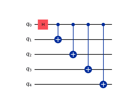

we can then call transpile() on it with scheduling_method set:
from qiskit import QuantumCircuit, transpile
backend = GenericBackendV2(5)
ghz = QuantumCircuit(5)
ghz.h(0)
ghz.cx(0,range(1,5))
circ = transpile(ghz, backend, scheduling_method="asap")
circ.draw(output='mpl')
Circuit diagram output by the previous code.

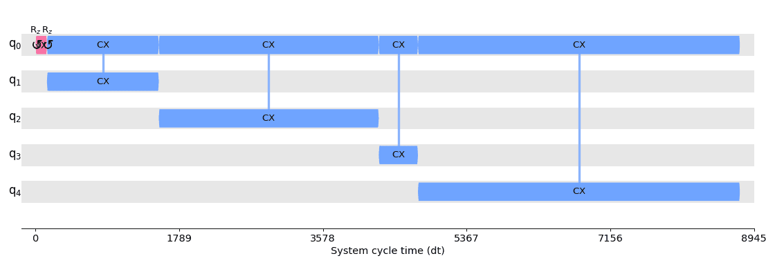

You can see here that the transpiler inserted Delay instructions to account for idle time on each qubit. To get a better idea of the timing of the circuit we can also look at it with the timeline.draw() function:
Output from circuit timeline drawer.
The scheduling of a circuit involves two parts: analysis and constraint mapping, followed by a padding pass. The first part requires running a scheduling analysis pass such as ALAPSchedulingAnalysis or ASAPSchedulingAnalysis which analyzes the circuit and records the start time of each instruction in the circuit using a scheduling algorithm (“as late as possible” for ALAPSchedulingAnalysis and “as soon as possible” for ASAPSchedulingAnalysis) in the property set. Once the circuit has an initial scheduling, additional passes can be run to account for any timing constraints on the target backend, such as alignment constraints. This is typically done with the ConstrainedReschedule pass which will adjust the scheduling set in the property set to the constraints of the target backend. Once all the scheduling and adjustments/rescheduling are finished, a padding pass, such as PadDelay or PadDynamicalDecoupling is run to insert the instructions into the circuit, which completes the scheduling.
