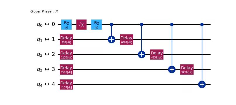

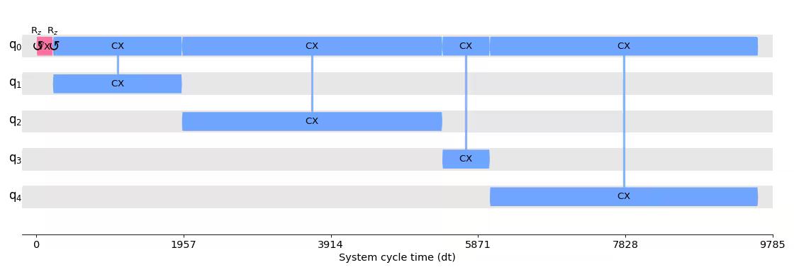

The scheduling stage, if requested, is responsible for inserting explicit Delay instructions to make idle periods of qubits explicit. Plugins may optionally choose to do walltime-sensitive transformations, such as inserting dynamical decoupling sequences.
The input to the scheduling stage is an ISA-compatible circuit. The output of the scheduling stage must also be an ISA-compatible circuit, with explicit Delay instructions that satisfy the hardware’s timing information, if appropriate.
The scheduling stage should set the node_start_time property in the pipeline’s PropertySet.
When writing stage plugins, the entry point for scheduling is qiskit.transpiler.scheduling. The built-in plugins are:
Method
Summary
defaultAttempt to satisfy timing alignment constraints without otherwise scheduling.
alapSchedule the circuit, preferring operations to be as late as possible.
asapSchedule the circuit, preferring operations to be as soon as possible.
Built-in default plugin
Do nothing, unless the circuit already contains instructions with explicit timings. If there are explicitly timed operations in the circuit, insert additional padding to ensure that these timings satisfy the alignment and other hardware constraints.
Builtin alap plugin
Explicitly schedule all operations using an “as late as possible” strategy. This uses the ALAPScheduleAnalysis algorithm to decide where to place gates.
Builtin asap plugin
Explicitly schedule all operations using an “as soon as possible” strategy. This uses the ASAPScheduleAnalysis algorithm to decide where to place gates.

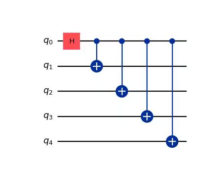

from qiskit import QuantumCircuit, transpile
from qiskit.providers.fake_provider import GenericBackendV2
backend = GenericBackendV2(5)
ghz = QuantumCircuit(5)
ghz.h(0)
ghz.cx(0,range(1,5))
circ = transpile(ghz, backend, scheduling_method="asap")
circ.draw(output='mpl')
Circuit diagram output by the previous code.
You can see here that the transpiler inserted Delay instructions to account for idle time on each qubit. To get a better idea of the timing of the circuit we can also look at it with the timeline.draw() function:
Output from circuit timeline drawer.
The scheduling of a circuit involves two parts: analysis and constraint mapping, followed by a padding pass. The first part requires running a scheduling analysis pass such as ALAPSchedulingAnalysis or ASAPSchedulingAnalysis which analyzes the circuit and records the start time of each instruction in the circuit using a scheduling algorithm (“as late as possible” for ALAPSchedulingAnalysis and “as soon as possible” for ASAPSchedulingAnalysis) in the property set. Once the circuit has an initial scheduling, additional passes can be run to account for any timing constraints on the target backend, such as alignment constraints. This is typically done with the ConstrainedReschedule pass which will adjust the scheduling set in the property set to the constraints of the target backend. Once all the scheduling and adjustments/rescheduling are finished, a padding pass, such as PadDelay or PadDynamicalDecoupling is run to insert the instructions into the circuit, which completes the scheduling.
