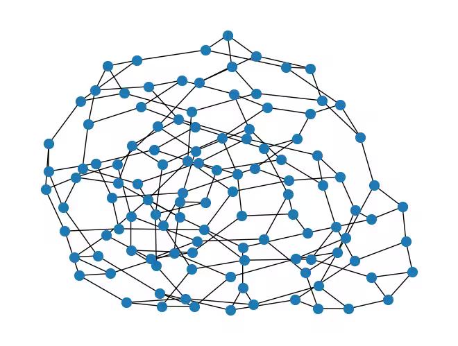

1. Define the problem
You can run a max-cut problem by defining a graph problem and specifying problem_type='maxcut'.
import networkx as nx
import numpy as np
# Generate a random graph with 156 nodes
maxcut_graph = nx.random_regular_graph(d=3, n=156, seed=8)
# Optionally, visualize the graph
nx.draw_networkx(
    maxcut_graph, nx.kamada_kawai_layout(maxcut_graph), node_size=100
Output:
Output of the previous code cell

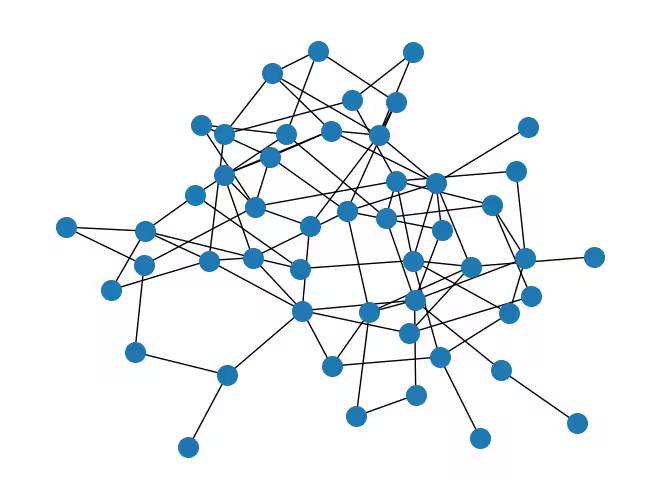

Define a random graph partitioning problem by generating a graph with randomly weighted nodes.
from sympy import Symbol, Poly, srepr
# To change the weights, change the seed to any integer.
rng_seed = 18
_rng = np.random.default_rng(rng_seed)
node_count = 50
edge_probability = 0.08
graph = nx.erdos_renyi_graph(
    node_count, edge_probability, seed=rng_seed, directed=False
# add node weights
min_weight = -1.0
max_weight = 1.0
for i in graph.nodes:
    weight = (max_weight - min_weight) * _rng.random() + min_weight
    graph.add_node(i, weight=weight)
nx.draw_networkx(graph, nx.kamada_kawai_layout(graph), node_size=200)
Output:
