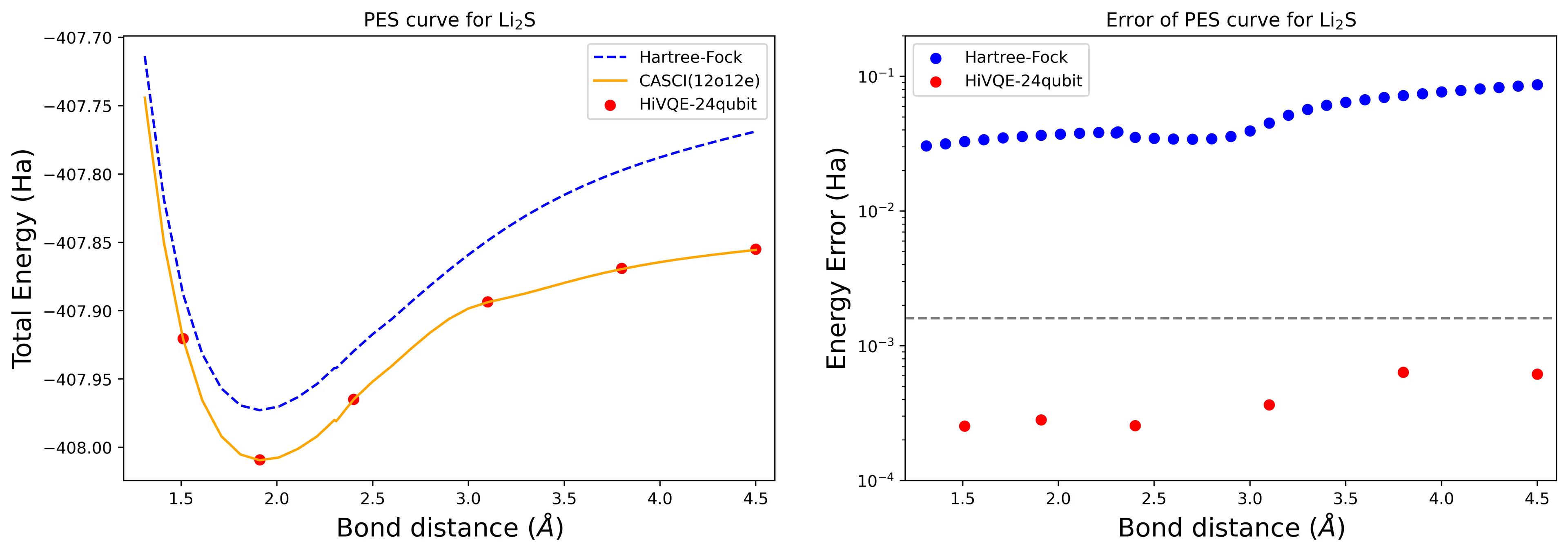

This section shows the demonstrated benchmark calculations of HI-VQE with a 24-qubit case for Li2S, a 40-qubit case for an N2 molecule, and a 44-qubit case for an FeP-NO system.
Dissociation potential energy surface curve for an Li2S molecule with 24 qubits
The PES curve is shown with the FCI reference and initial guess from RHF, together with the energy error from the FCI reference.

The red dots represent the HI-VQE calculation results for six different geometries, and three geometries corresponding to 1.51, 2.40, and 3.80 Angstrom are provided as input in the above cell.

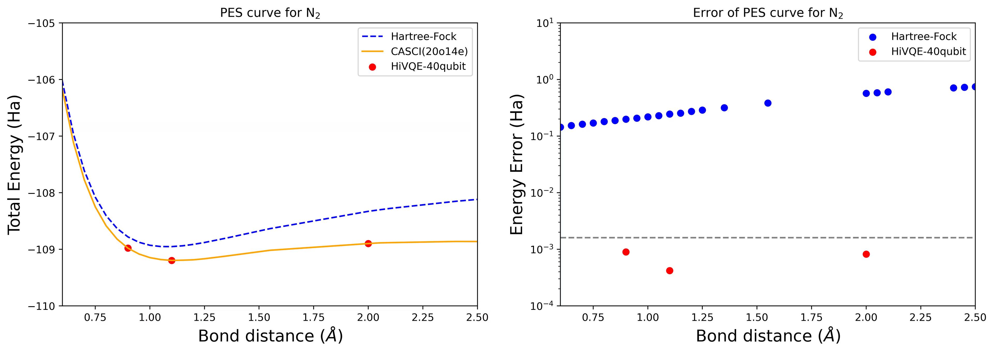

Dissociation PES curve for an N2 molecule with 40 qubits
The nitrogen molecule has been identified as a multireference system with large correlation energy contributions beyond the Hartree-Fock state. We conducted a benchmark calculation for the N2 molecule with cc-pvdz basis, (20o,14e) using the homo-lumo active orbital selection. The complete active space (CAS) number to represent this problem is 6,009,350,400. It is not possible to obtain the eigenvalue problem solution (for energy and electronic structure) with this number of states using a powerful desktop (16cpu/64GB). With HI-VQE, users can efficiently search the subspace of CAS states to find chemically accurate results while saving computation resources significantly. The following plots show the PES curve of 40 qubits HI-VQE calculation of the N2 molecule dissociation.
Image showing that HI-VQE produces solutions within chemical accuracy of a classical reference PES curve for the N2 system

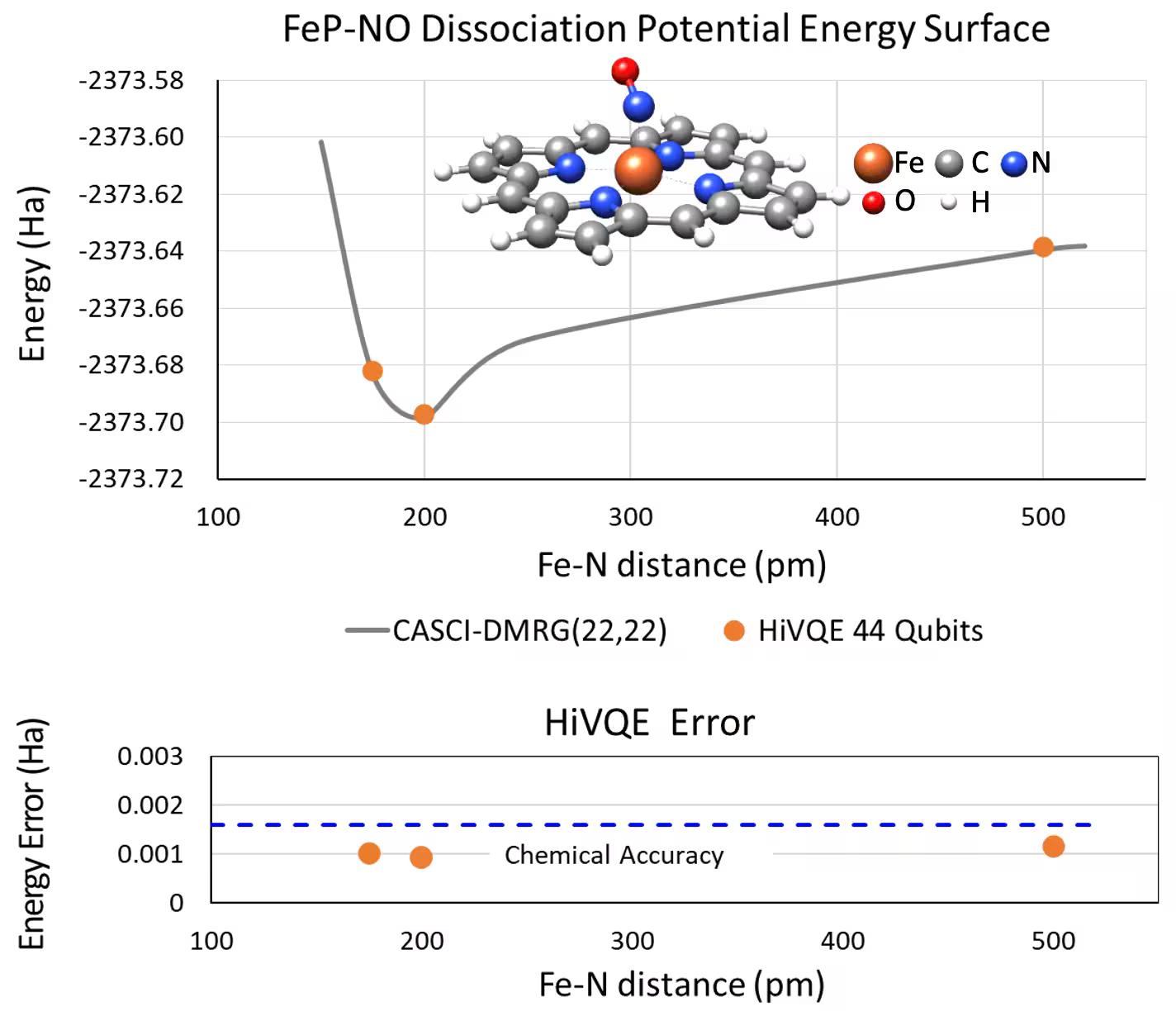

Dissociation PES curve for five-coordinated iron(II)-porphyrin with an NO system with 44 qubits
Another interesting chemical system is an iron(II)-porphyrin (FeP) complex with a coordinated nitric oxide (NO) ligand, which represents a biologically relevant metalloporphyrin system that plays crucial roles in various physiological processes. In this example, HI-VQE has been utilized to estimate the accurate potential energy surface curve of the intermolecular interaction between FeP and NO (ground state energy for differently separated geometries). The combined system has 450 orbitals and 202 electrons (450o,202e) with 6-31g(d) basis in total. The homo-lumo active orbital selection was utilized to calculate the smaller case from the real case with (22o,22e). From the following benchmark results, we were able to achieve the chemical accuracy (> 1.6 mHa) with a state-of-the-art classical computer chemistry calculation of CASCI(DMRG) (22o,22e) reference.
Image showing that HI-VQE produces solutions within chemical accuracy of a classical reference PES curve for the FeP-NO system
