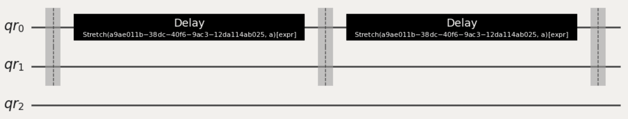

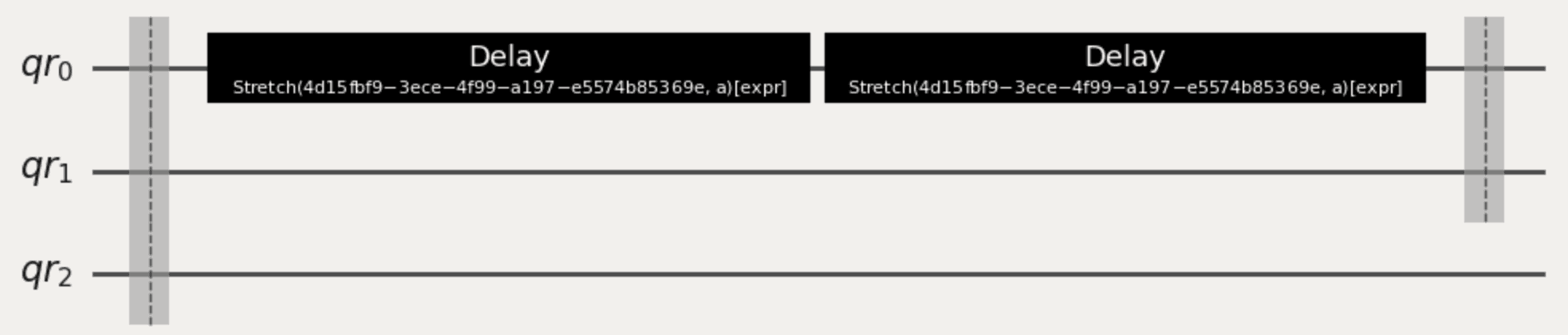

  • The area surrounded by a set of barriers is called a barrier region. A stretch variable cannot be used in multiple barrier regions.
    # Stretch a is used in two barrier regions
    a = circuit.add_stretch("a")
    circuit.barrier((q0, q1))
    circuit.delay(a, q0)
    Illustration of the previous code output
    Invalid use of stretch in barrier regions
