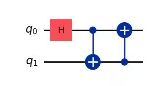

The process of transpilation takes a circuit that contains your instructions:

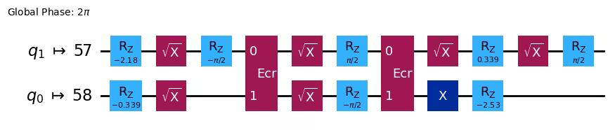

Transpilation then transforms it such that only instructions available on a chosen backend are used, and optimizes those instructions to minimize the effects of noise:
