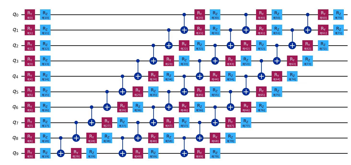

ansatz.draw("mpl", style="iqp")

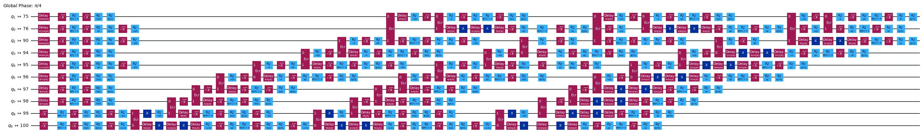

isa_observable = hamiltonian.apply_layout(isa_ansatz.layout)
isa_ansatz.draw("mpl", scale=0.6, style="iqp", fold=-1, idle_wires=False)

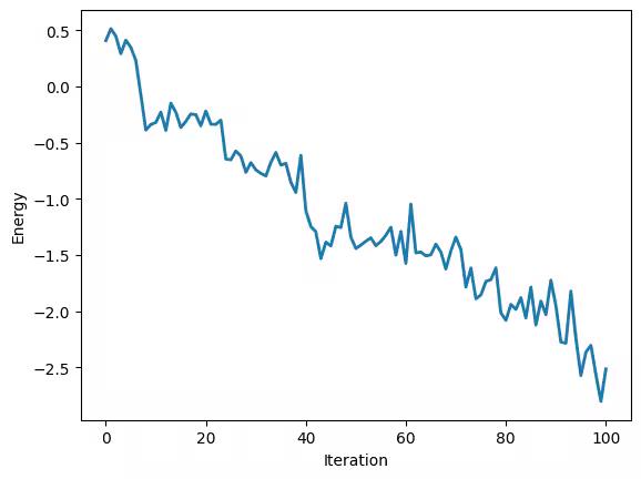

results = {
    "spsa": spsa_history,
visualize_results(spsa_history)
