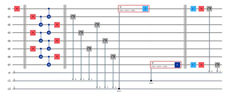

Apply feedforward corrections to correct Pauli byproduct operators
The Bell-basis measurements introduce Pauli byproducts that must be corrected using the recorded outcomes. This is done in two steps. First, we need to compute the parity of all ZZZZ measurements, which is then used to conditionally apply an XX gate to the target qubit. Likewise, the parity of the XXXX measurements is computed and used to conditionally apply a ZZ gate to the control qubit.
With the new classical expression framework in Qiskit, these parities can be computed directly in the classical processing layer of the circuit. Instead of applying a sequence of individual conditional gates for each measurement bit, we can build a single classical expression that represents the XOR (parity) of all relevant measurement outcomes. This expression is then used as the condition in a single if_test block, allowing the correction gates to be applied in constant depth. This approach both simplifies the circuit and ensures that the feedforward corrections do not introduce unnecessary additional latency.

Measure control and target qubits
We define a helper function that enables measurement of the control and target qubits in the XXXX, YYYY, or ZZZZ bases. For verifying the Bell state (00+11)/2(|00\rangle + |11\rangle)/\sqrt{2}, the expectation values of XXXX and ZZZZ should both be +1+1, since they are stabilizers of the state. The YYYY measurement is also supported here and will be used below when computing the fidelity.

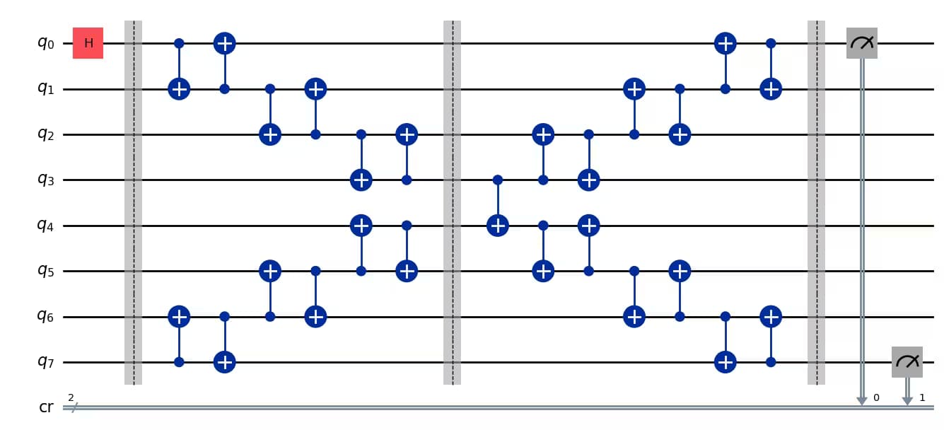

Unitary-based implementation swapping the qubits to the middle
For comparison, we first examine the case where a long-range CNOT gate is implemented using nearest-neighbor connections and unitary gates. In the following figure, on the left is a circuit for a long-range CNOT gate spanning a 1D chain of n-qubits subject to nearest-neighbor connections only. In the middle is an equivalent unitary decomposition implementable with local CNOT gates, circuit depth O(n)O(n).
Long-range CNOT circuit
The circuit in the middle can be implemented as follows:

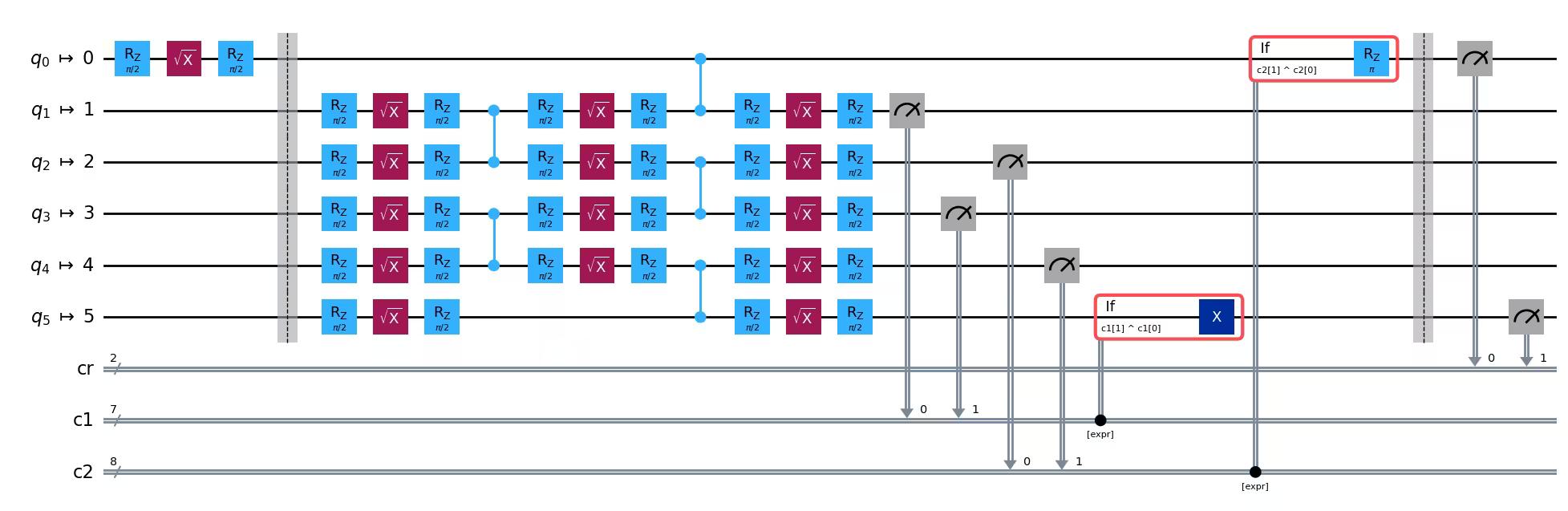

    f"{isa_circuits_dyn[14].depth(lambda x: x.operation.num_qubits == 2)}"
isa_circuits_dyn[14].draw("mpl", fold=-1, idle_wires=0)
Output:
2Q depth: 2
Output of the previous code cell
print(
    f"2Q depth: "
    f"{isa_circuits_uni[14].depth(lambda x: x.operation.num_qubits == 2)}"
isa_circuits_uni[14].draw("mpl", fold=-1, idle_wires=False)
Output:
2Q depth: 13

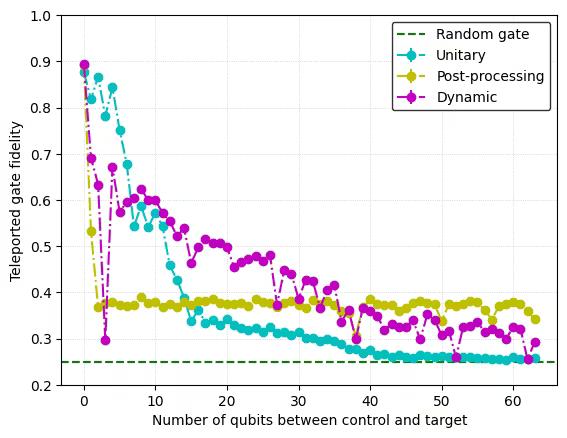

From the fidelity plot above, the LRCX did not consistently outperform the direct unitary implementation. In fact, for short control–target separations, the unitary circuit achieved higher fidelity. However, at larger separations, the dynamic circuit begins to achieve better fidelity than the unitary implementation. This behavior is not unexpected on current hardware: while dynamic circuits reduce circuit depth by avoiding long SWAP chains, they introduce additional circuit time from mid-circuit measurements, classical feedforward, and control-path delays. The added latency increases decoherence and readout errors, which can outweigh the depth savings at short distances.
Nevertheless, we observe a crossover point where the dynamic approach surpasses the unitary one. This is a direct result of the different scaling: the depth of the unitary circuit grows linearly with the distance between qubits, while the depth of the dynamic circuit remains constant.
Key points:
  • Immediate benefit of dynamic circuits: The main present-day motivation is reduced two-qubit depth, not necessarily improved fidelity.
  • Why fidelity can be worse today: Increased circuit time from measurement and classical operations often dominates, especially when the control–target separation is small.
  • Looking forward: As hardware improves, specifically faster readout, shorter classical control latency, and reduced mid-circuit overhead, we should expect these depth and duration reductions to translate into measurable fidelity gains.

fig, axes = plt.subplots(1, 2, figsize=(12, 5))
axes[0].plot(
    distances, depths_2q_uni, "o-.", color="c", label="Unitary (2Q depth)"
axes[0].plot(
    distances, depths_2q_dyn, "o-.", color="m", label="Dynamic (2Q depth)"
axes[0].set_xlabel("Number of qubits between control and target")
axes[0].set_ylabel("Two-qubit depth")
axes[0].grid(True, linestyle=":", linewidth=0.6, alpha=0.4)
axes[0].legend()
axes[1].plot(
    distances, meas_uni, "o-.", color="c", label="Unitary (# measurements)"
axes[1].plot(
    distances, meas_dyn, "o-.", color="m", label="Dynamic (# measurements)"
axes[1].set_xlabel("Number of qubits between control and target")
axes[1].set_ylabel("Number of measurements")
axes[1].grid(True, linestyle=":", linewidth=0.6, alpha=0.4)
axes[1].legend()
fig.suptitle("Scaling of Unitary vs Dynamic LRCX with Distance", fontsize=12)
plt.tight_layout()
plt.show()
Output:
This two-qubit depth plot highlights the primary advantage of the LRCX implemented with dynamic circuits: performance remains essentially constant as the separation between control and target qubits increases. In contrast, the unitary implementation grows linearly with distance due to the required SWAP chains. Depth captures the logical scaling of two-qubit operations, while the measurement count reflects the additional overhead for dynamic circuits. These measurements are efficient, since they are performed in parallel, but they still introduce a fixed cost on today’s hardware.
Why fidelity can be worse today: Increased circuit time from measurement and classical operations often dominates, especially when the control-target separation is small. For example, the average readout length on a Heron r2 processor is 2,280 ns, whereas its 2Q gate length is only 68 ns.
As measurement and classical latencies improve, we expect the constant-depth and constant-measurement scaling of dynamic circuits to yield clear fidelity and runtime advantages on larger circuits.
