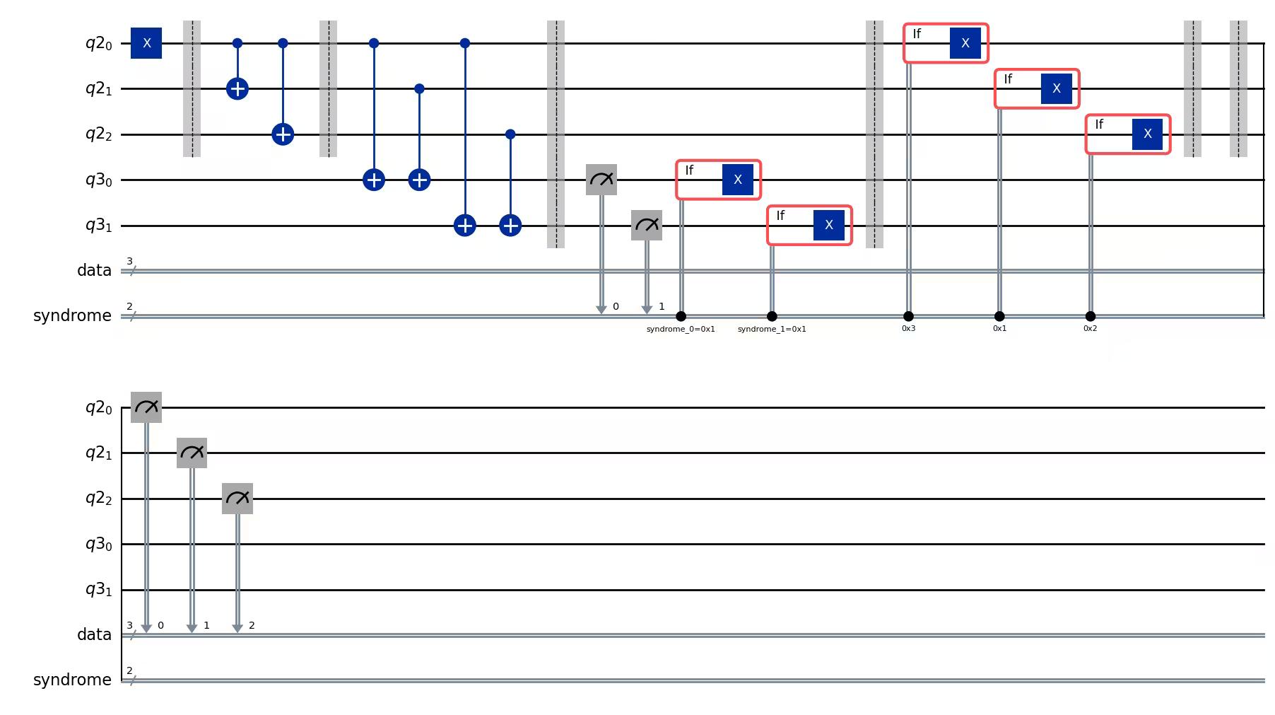

Build a sequence of bit-flip stabilizer circuits implementing multiple rounds of error detection and correction
The bit-flip code is among the simplest examples of a stabilizer code. It protects the state against a single bit-flip (X) error on any of the encoding qubits. Consider the action of bit-flip error XX, which maps ∣0⟩→∣1⟩|0\rangle \rightarrow |1\rangle and ∣1⟩→∣0⟩|1\rangle \rightarrow |0\rangle on any of our qubits, then we have ϵ={E0,E1,E2}={IIX,IXI,XII}\epsilon = \{E_0, E_1, E_2 \} = \{IIX, IXI, XII\}. The code requires five qubits: three are used to encode the protected state (the "data qubits"), and the remaining two are used as stabilizer measurement ancillas.
Below you will build circuits that (1) prepare the data qubits in the logical ∣1ˉ⟩|\bar{1} \rangle state, then (2) run multiple cycles of a 5μs5 \mu s delay followed by error correction (including reset of the syndrome qubits), and (3) read out the state of the data qubits.
We will also test the lifetime of the ∣1⟩|1\rangle state without using error correction by including three reference qubits that we prepare in the ∣1⟩|1\rangle state, leave idle, and then read out.

def encode_bit_flip(circuit, qreg_data, qreg_ref=None) -> QuantumCircuit:
    """Encode bit-flip. This is done by simply adding a cx"""
    for q in qreg_data:
        circuit.x(q)
    if qreg_ref:
        for q in qreg_ref:
            circuit.x(q)
    circuit.barrier()
    return circuit
def measure_syndrome_bit(
    circuit, qreg_data, qreg_syndrome, creg_syndrome, qreg_ref=None
    Measure the syndrome by measuring the parity.
    We reset our ancilla qubits after measuring the stabilizer
    so we can reuse them for repeated stabilizer measurements.
    Because we have already observed the state of the qubit,
    we can write the conditional reset protocol directly to
    avoid another round of qubit measurement if we used
    the `reset` instruction.
    circuit.cx(qreg_data[0], qreg_syndrome[0])
    circuit.cx(qreg_data[1], qreg_syndrome[0])
    circuit.cx(qreg_data[0], qreg_syndrome[1])
    circuit.cx(qreg_data[2], qreg_syndrome[1])
    circuit.barrier()
    for q_measure, c_measure in zip(qreg_syndrome, creg_syndrome):
        circuit.append(MidCircuitMeasure(), [q_measure], [c_measure])
    with circuit.if_test((creg_syndrome[0], 1)):
        circuit.x(qreg_syndrome[0])
    with circuit.if_test((creg_syndrome[1], 1)):
        circuit.x(qreg_syndrome[1])
    circuit.barrier()
    return circuit
def apply_correction_bit(circuit, qreg_data, creg_syndrome):
    """We can detect where an error occurred and correct our state"""
    with circuit.if_test((creg_syndrome, 3)):
        circuit.x(qreg_data[0])
    with circuit.if_test((creg_syndrome, 1)):
        circuit.x(qreg_data[1])
    with circuit.if_test((creg_syndrome, 2)):
        circuit.x(qreg_data[2])
    circuit.barrier()
    return circuit

circuits, rep_array = build_error_correction_sequence(
    num_cycles, cycles_per_circuit, nq_ref=3, delay=5
circuits[1].draw(output="mpl", cregbundle=False, fold=50)

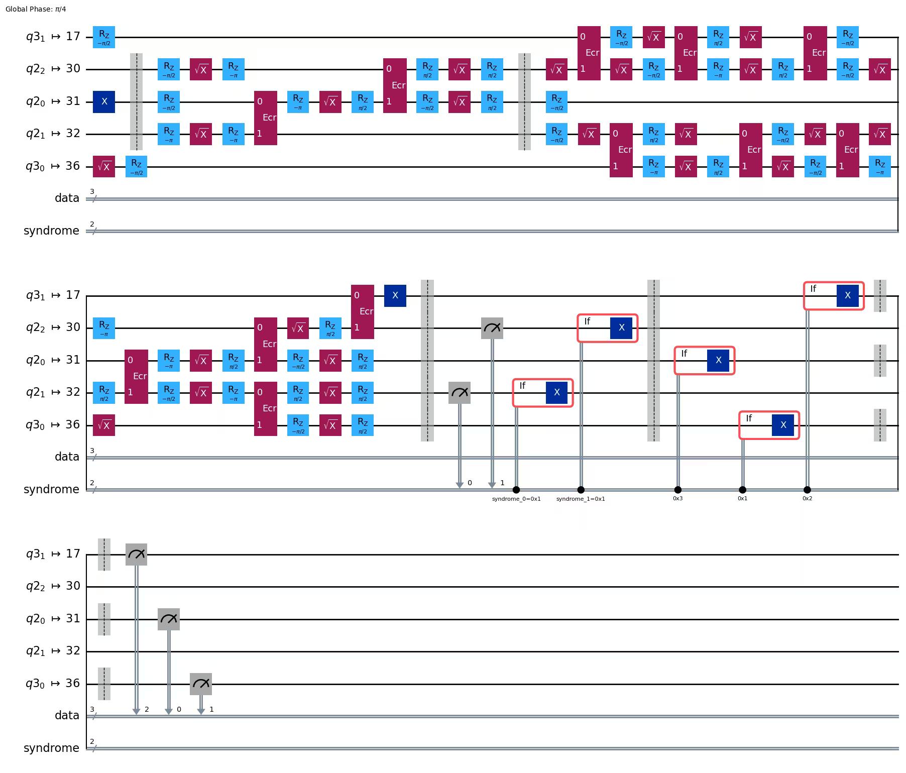

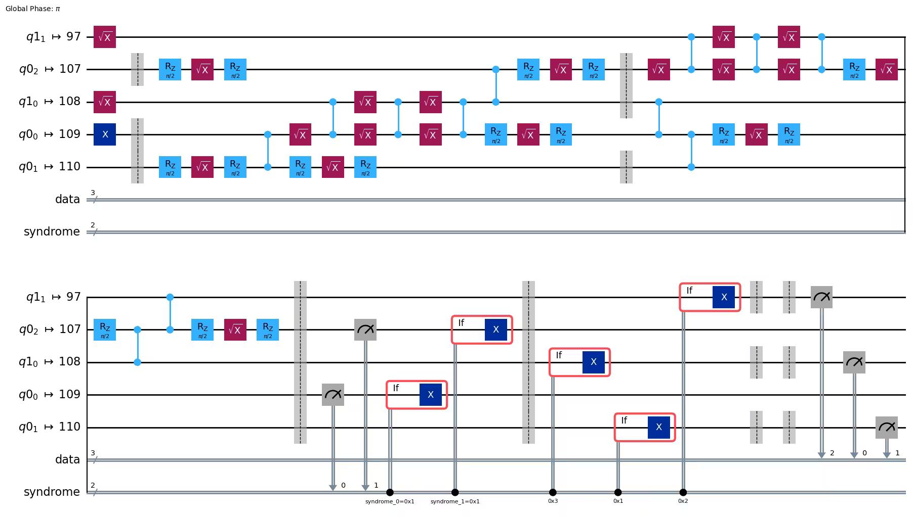

Step 2: Optimize the problem for quantum hardware execution
To reduce the total job execution time, Qiskit primitives only accept circuits and observables that conform to the instructions and connectivity supported by the target system (referred to as instruction set architecture (ISA) circuits and observables). Learn more about transpilation.
Generate ISA circuits
We will start by finding an initial layout (as in, a selection of physical qubits to map our circuits to) by transpiling the longest of our circuits using the preset pass manager with optimization level 3.
from qiskit.transpiler.preset_passmanagers import generate_preset_pass_manager
pm = generate_preset_pass_manager(backend=backend, optimization_level=3)
isa_circuit_ref = pm.run(circuits[-1])

# now we transpile all circuits to this initial layout; this way each circuit is run on the same qubits and we can make a fair comparison
    backend=backend,
    optimization_level=3,
    initial_layout=init_layout,
isa_circuits = pm.run(circuits)
isa_circuits[1].draw("mpl", cregbundle=False, fold=50)
