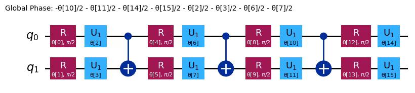

Construct an ansatz and Hamiltonian which model a 10-spin Heisenberg chain. First, we import some generic packages and create a couple of helper functions.
num_spins = 10
ansatz = efficient_su2(num_qubits=num_spins, reps=3)

ansatz.draw("mpl", style="iqp")

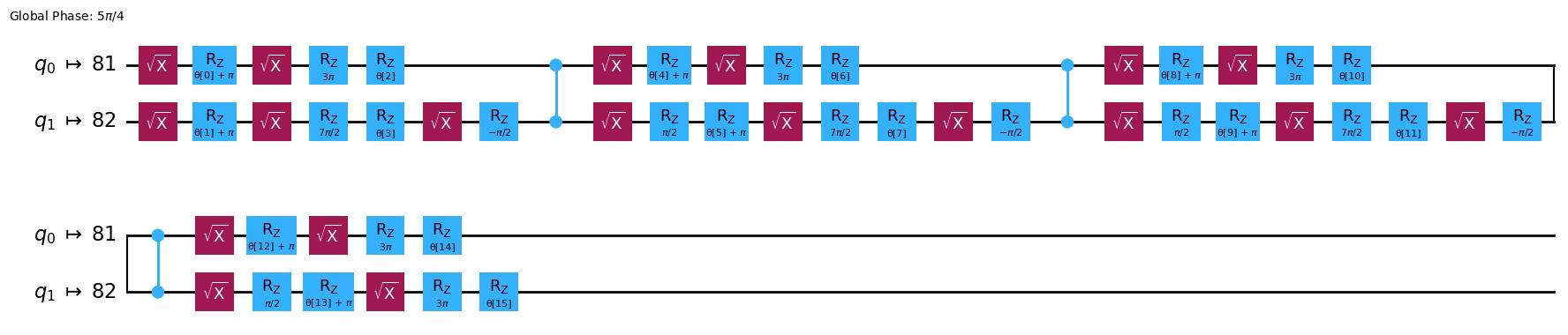

Use the generate_preset_pass_manager function from Qiskit to automatically generate an optimization routine for our circuit with respect to the selected QPU. We choose optimization_level=3, which provides the highest level of optimization of the preset pass managers. We also include ALAPScheduleAnalysis and PadDynamicalDecoupling scheduling passes to suppress decoherence errors.
target = backend.target
pm = generate_preset_pass_manager(optimization_level=3, backend=backend)
pm.scheduling = PassManager(
        ALAPScheduleAnalysis(durations=target.durations()),
        PadDynamicalDecoupling(
            durations=target.durations(),
            dd_sequence=[XGate(), XGate()],
            pulse_alignment=target.pulse_alignment,
ansatz_ibm = pm.run(ansatz)
observable_ibm = hamiltonian.apply_layout(ansatz_ibm.layout)
ansatz_ibm.draw("mpl", scale=0.6, style="iqp", fold=-1, idle_wires=False)

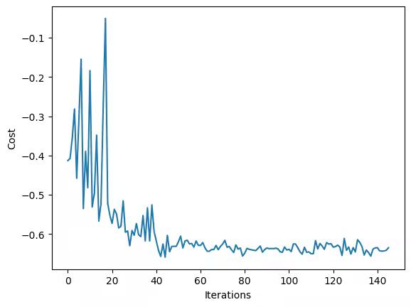

Minimize the estimated ground state energy of the system by optimizing the circuit parameters. Use the Estimator primitive from Qiskit Runtime to evaluate the cost function during optimization.
Since we optimized the circuit for the backend in Step 2, we can avoid doing transpilation on the Runtime server by setting skip_transpilation=True and passing the optimized circuit. For this demo, we will run on a QPU using qiskit-ibm-runtime primitives. To run with qiskit statevector-based primitives, replace the block of code using Qiskit IBM Runtime primitives with the commented block.

num_params = ansatz_ibm.num_parameters
params = 2 * np.pi * np.random.random(num_params)
callback_dict = {
    "prev_vector": None,
    "iters": 0,
    "cost_history": [],
# Evaluate the problem on a QPU by using Qiskit IBM Runtime
with Session(backend=backend) as session:
    estimator = Estimator()
    callback = build_callback(
        ansatz_ibm, observable_ibm, estimator, callback_dict
    res = minimize(
        cost_func,
        x0=params,
        args=(ansatz_ibm, observable_ibm, estimator),
        callback=callback,
        method="cobyla",
        options={"maxiter": 100},
visualize_results(callback_dict)
