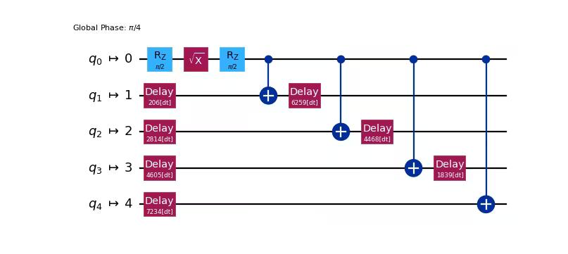

pass_manager.scheduling = scheduling_pm
Now, when the staged pass manager is run via the run() method, the logical_opt pass manager will be called before the layout stage, and the scheduling_pm pass manager will be used for the scheduling stage instead of the default.

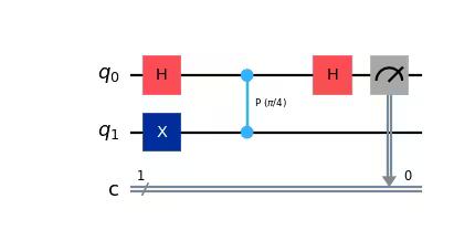

import numpy as np
from qiskit.providers.fake_provider import GenericBackendV2
backend = GenericBackendV2(5)
qc = QuantumCircuit(2, 1)
qc.h(0)
qc.x(1)
qc.cp(np.pi/4, 0, 1)
qc.h(0)
qc.measure([0], [0])
qc.draw(output='mpl')
../_images/transpiler-4.png

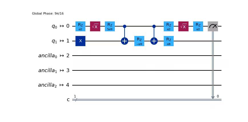

We have HH, XX, and controlled-PP gates, none of which are in our device’s basis gate set, and thus must be translated. We can transpile the circuit to show what it will look like in the native gate set of the target IBM Quantum device (the GenericBackendV2 class generates a fake backend with a specified number of qubits for test purposes):
from qiskit import transpile
qc.h(0)
qc.x(1)
qc.h(0)
qc_basis = transpile(qc, backend)
qc_basis.draw(output='mpl')
../_images/transpiler-5.png
A few things to highlight. First, the circuit has gotten longer with respect to the original. This can be verified by checking the depth of both circuits:
print('Original depth:', qc.depth(), 'Decomposed Depth:', qc_basis.depth())
Original depth: 4 Decomposed Depth: 10
Second, although we had a single controlled gate, the fact that it was not in the basis set means that, when expanded, it requires more than a single CXGate to implement. All said, unrolling to the basis set of gates leads to an increase in the depth of a quantum circuit and the number of gates.

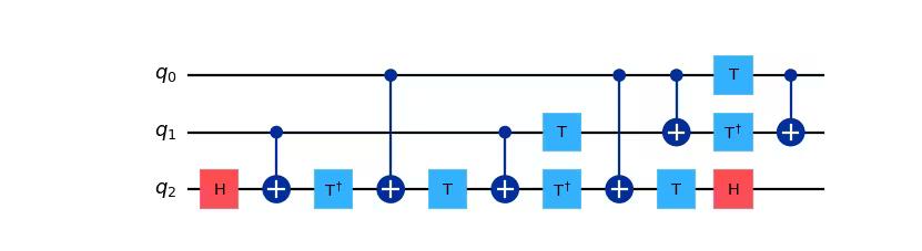

  2. A Toffoli, or controlled-controlled-not gate (ccx), is a three-qubit gate. Given that our basis gate set includes only single- and two-qubit gates, it is obvious that this gate must be decomposed. This decomposition is quite costly:
    ccx_circ = QuantumCircuit(3)
    ccx_circ.ccx(0, 1, 2)
    ccx_circ.decompose().draw(output='mpl')
    ../_images/transpiler-6.png
    For every Toffoli gate in a quantum circuit, the hardware may execute up to six CNOT gates, and a handful of single-qubit gates. From this example, it should be clear that any algorithm that makes use of multiple Toffoli gates will end up as a circuit with large depth and will therefore be appreciably affected by noise and gate errors.

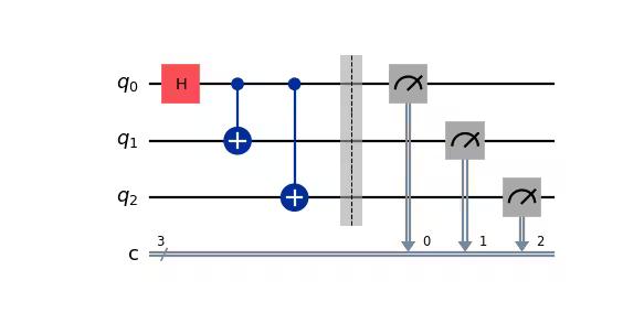

Let’s see what layouts are automatically picked at various optimization levels. The circuits returned by qiskit.compiler.transpile() are annotated with this initial layout information, and we can view this layout selection graphically using qiskit.visualization.plot_circuit_layout():
from qiskit import QuantumCircuit, transpile
from qiskit.visualization import plot_circuit_layout
from qiskit.providers.fake_provider import Fake5QV1
backend = Fake5QV1()
ghz = QuantumCircuit(3, 3)
ghz.h(0)
ghz.cx(0,range(1,3))
ghz.barrier()
ghz.measure(range(3), range(3))
ghz.draw(output='mpl')
../_images/transpiler-7.png

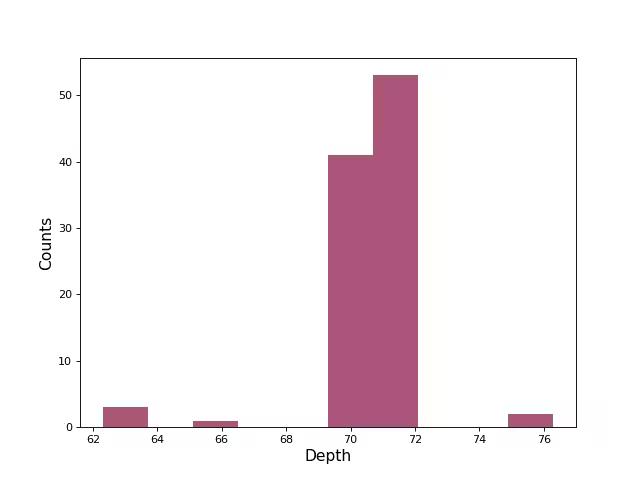

In order to highlight this, we run a GHZ circuit 100 times, using a “bad” (disconnected) initial_layout in a heavy hex coupling map:
../_images/transpiler-11.png
from qiskit.transpiler import CouplingMap
coupling_map = CouplingMap.from_heavy_hex(3)
backend = GenericBackendV2(coupling_map.size(), coupling_map=coupling_map)
ghz = QuantumCircuit(15)
ghz.h(0)
ghz.cx(0, range(1, 15))
depths = []
for i in range(100):
    depths.append(
        transpile(
            ghz,
            backend,
            seed_transpiler=i,
            layout_method='trivial'  # Fixed layout mapped in circuit order
        ).depth()
plt.figure(figsize=(8, 6))
plt.hist(depths, align='left', color='#AC557C')
plt.xlabel('Depth', fontsize=14)
plt.ylabel('Counts', fontsize=14);
../_images/transpiler-12.png
This distribution is quite wide, signaling the difficulty the swap mapper is having in computing the best mapping. Most circuits will have a distribution of depths, perhaps not as wide as this one, due to the stochastic nature of the default swap mapper. Of course, we want the best circuit we can get, especially in cases where the depth is critical to success or failure. The SabreSwap pass will by default by run its algorithm in parallel with multiple seed values and select the output which uses the fewest swaps. If you would like to increase the number of trials SabreSwap runs you can refer to Working with Preset Pass Managers and modify the routing stage with a custom instance of SabreSwap with a larger value for the trials argument.

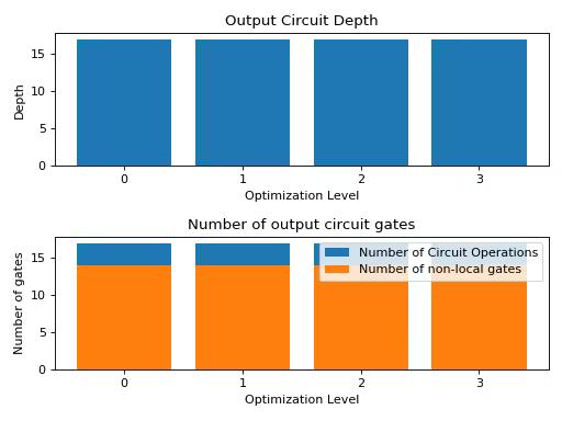

Decomposing quantum circuits into the basis gate set of the target device, and the addition of swap gates needed to match hardware topology, conspire to increase the depth and gate count of quantum circuits. Fortunately many routines for optimizing circuits by combining or eliminating gates exist. In some cases these methods are so effective the output circuits have lower depth than the inputs. In other cases, not much can be done, and the computation may be difficult to perform on noisy devices. Different gate optimizations are turned on with different optimization_level values. Below we show the benefits gained from setting the optimization level higher:
Important
The output from transpile() varies due to the stochastic swap mapper. So the numbers below will likely change each time you run the code.

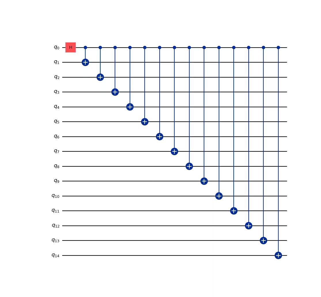

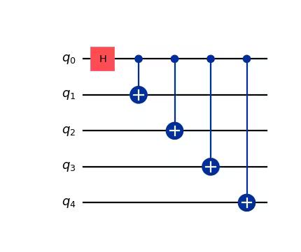

backend = GenericBackendV2(16)
ghz.h(0)
depths = []
gate_counts = []
non_local_gate_counts = []
levels = [str(x) for x in range(4)]
for level in range(4):
     circ = transpile(ghz, backend, optimization_level=level)
     depths.append(circ.depth())
     gate_counts.append(sum(circ.count_ops().values()))
     non_local_gate_counts.append(circ.num_nonlocal_gates())
fig, (ax1, ax2) = plt.subplots(2, 1)
ax1.bar(levels, depths, label='Depth')
ax1.set_xlabel("Optimization Level")
ax1.set_ylabel("Depth")
ax1.set_title("Output Circuit Depth")
ax2.bar(levels, gate_counts, label='Number of Circuit Operations')
ax2.bar(levels, non_local_gate_counts, label='Number of non-local gates')
ax2.set_xlabel("Optimization Level")
ax2.set_ylabel("Number of gates")
ax2.legend()
ax2.set_title("Number of output circuit gates")
fig.tight_layout()
plt.show()

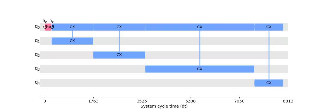

we can then call transpile() on it with scheduling_method set:
ghz = QuantumCircuit(5)
ghz.h(0)
ghz.cx(0,range(1,5))
circ = transpile(ghz, backend, scheduling_method="asap")
circ.draw(output='mpl')
../_images/transpiler-16.png

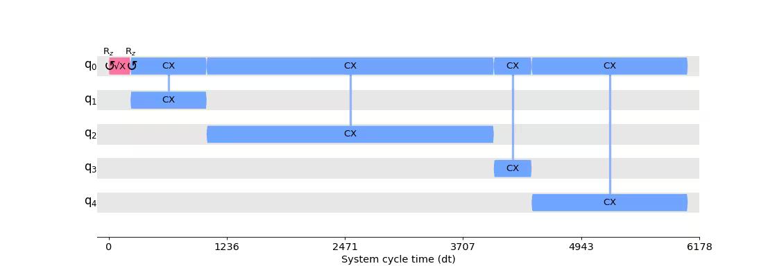

You can see here that the transpiler inserted Delay instructions to account for idle time on each qubit. To get a better idea of the timing of the circuit we can also look at it with the timeline.draw() function:
../_images/transpiler-17.png
The scheduling of a circuit involves two parts: analysis and constraint mapping, followed by a padding pass. The first part requires running a scheduling analysis pass such as ALAPSchedulingAnalysis or ASAPSchedulingAnalysis which analyzes the circuit and records the start time of each instruction in the circuit using a scheduling algorithm (“as late as possible” for ALAPSchedulingAnalysis and “as soon as possible” for ASAPSchedulingAnalysis) in the property set. Once the circuit has an initial scheduling, additional passes can be run to account for any timing constraints on the target backend, such as alignment constraints. This is typically done with the ConstrainedReschedule pass which will adjust the scheduling set in the property set to the constraints of the target backend. Once all the scheduling and adjustments/rescheduling are finished, a padding pass, such as PadDelay or PadDynamicalDecoupling is run to insert the instructions into the circuit, which completes the scheduling.
