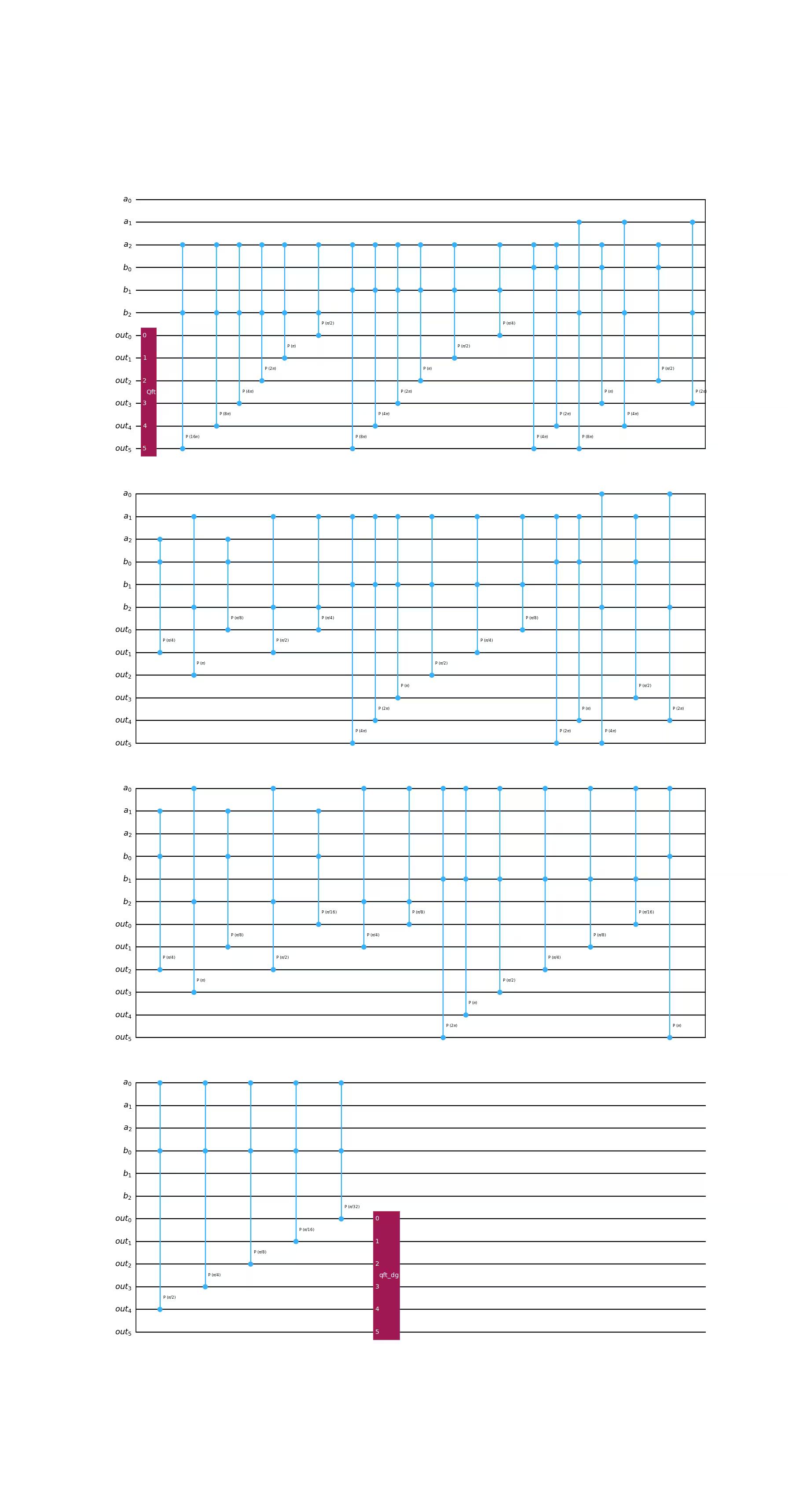

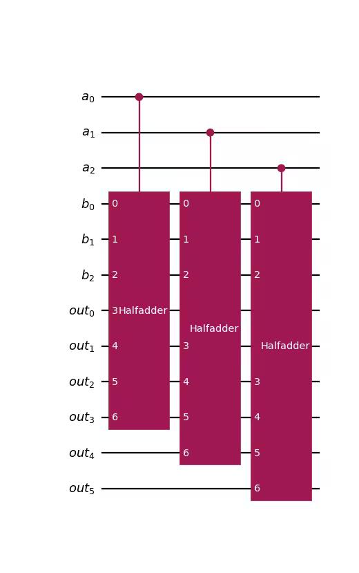

Multipliers
multiplier_cumulative_h18
qiskit.synthesis.multiplier_cumulative_h18(num_state_qubits, num_result_qubits=None)
GitHub
A multiplication circuit to store product of two input registers out-of-place.
The circuit uses the approach from Ref. [1]. As an example, a multiplier circuit that performs a non-modular multiplication on two 3-qubit sized registers is:
from qiskit.synthesis.arithmetic import multiplier_cumulative_h18
num_state_qubits = 3
circuit = multiplier_cumulative_h18(num_state_qubits)
circuit.draw("mpl")
Circuit diagram output by the previous code.
Multiplication in this circuit is implemented in a classical approach by performing a series of shifted additions using one of the input registers while the qubits from the other input register act as control qubits for the adders.
Parameters
  • num_state_qubits (int) – The number of qubits in either input register for state ∣a⟩|a\rangle or ∣b⟩|b\rangle. The two input registers must have the same number of qubits.
  • num_result_qubits (int | None) – The number of result qubits to limit the output to. If number of result qubits is nn, multiplication modulo 2n2^n is performed to limit the output to the specified number of qubits. Default value is 2 * num_state_qubits to represent any possible result from the multiplication of the two inputs.
Raises
ValueError – If num_result_qubits is given and not valid, meaning not in [num_state_qubits, 2 * num_state_qubits].
Return type
QuantumCircuit
References:
[1] Häner et al., Optimizing Quantum Circuits for Arithmetic, 2018. arXiv:1805.12445
