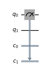

  1. QuantumCircuit.measure : measures each qubit in the first argument onto the classical bit given as the second argument. This method allows full control over where the measurement result is stored.

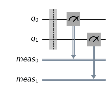

  2. QuantumCircuit.measure_all : takes no argument and can be used for quantum circuits without pre-defined classical bits. It creates classical wires and stores measurement results in order. For example, measurement of qubit qiq_i is stored in cbit measimeas_i). It also adds a barrier before the measurement.
  3. QuantumCircuit.measure_active : similar to measure_all, but measures only qubits that have operations.
qc1 = QuantumCircuit(2, 2)
qc1.measure(0, 1)
qc1.draw("mpl", cregbundle=False)
Output:
Output of the previous code cell
qc2 = QuantumCircuit(2)
qc2.measure_all()
qc2.draw("mpl", cregbundle=False)
Output:

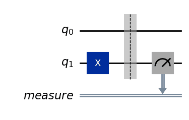

qc3 = QuantumCircuit(2)
qc3.x(1)
qc3.measure_active()
qc3.draw("mpl", cregbundle=False)
Output:
