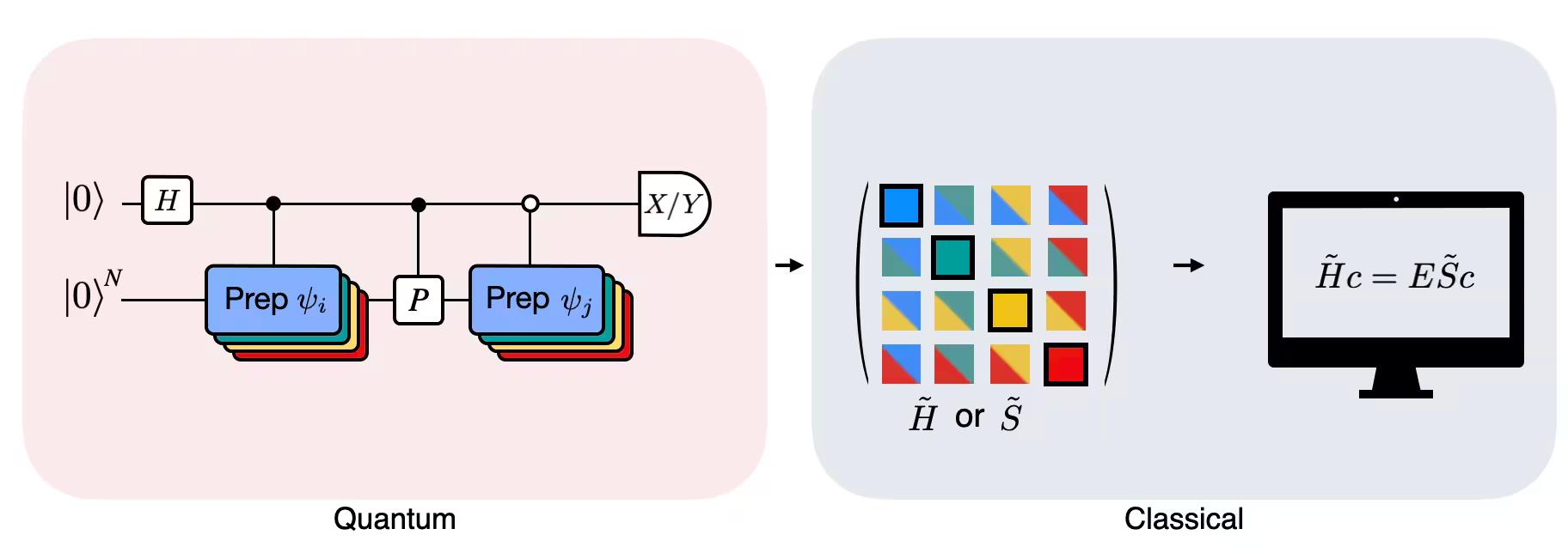

Krylov quantum diagonalization algorithm
Given an Hamiltonian HH that we wish to diagonalize, first we consider the corresponding unitary Krylov space KU\mathcal{K}_U. The goal is to find a compact representation of the Hamiltonian in KU\mathcal{K}_U, which we'll refer to as H~\tilde{H}. The matrix elements of H~\tilde{H}, the projection of the Hamiltonian in the Krylov space, can be calculated by calculating the following expectation values
H~mn=ψmHψn=\tilde{H}_{mn} = \langle \psi_m \vert H \vert \psi_n \rangle = =ψeiHtmHeiHtnψ= \langle \psi \vert e^{i H t_m} H e^{-i H t_n} \vert \psi \rangle =ψeiHmdtHeiHndtψ= \langle \psi \vert e^{i H m dt} H e^{-i H n dt} \vert \psi \rangle
Where ψn=eiHtnψ\vert \psi_n \rangle = e^{-i H t_n} \vert \psi \rangle are the vectors of the unitary Krylov space and tn=ndtt_n = n dt are the multiples of the time step dtdt chosen. On a quantum computer, the calculation of each matrix elements can be done with any algorithm which allows to obtain overlap between quantum states. This tutorial focuses on the Hadamard test. Given that the KU\mathcal{K}_U has dimension rr, the Hamiltonian projected into the subspace will have dimensions r×rr \times r. With rr small enough (generally r<<100r<<100 is sufficient to obtain convergence of estimates of eigenenergies) we can then easily diagonalize the projected Hamiltonian H~\tilde{H}. However, we cannot directly diagonalize H~\tilde{H} because of the non-orthogonality of the Krylov space vectors. We'll have to measure their overlaps and construct a matrix S~\tilde{S}
S~mn=ψmψn\tilde{S}_{mn} = \langle \psi_m \vert \psi_n \rangle
This allows us to solve the eigenvalue problem in a non-orthogonal space (also called generalized eigenvalue problem)
H~ c=E S~ c\tilde{H} \ \vec{c} = E \ \tilde{S} \ \vec{c}
One can then obtain estimates of the eigenvalues and eigenstates of HH by looking at the ones of H~\tilde{H}. For example, the estimate of the ground state energy is obtained by taking the smallest eigenvalue cc and the ground state from the corresponding eigenvector c\vec{c}. The coefficients in c\vec{c} determines the contribution of the different vectors that span KU\mathcal{K}_U.
The Figure shows a circuit representation of the modified Hadamard test, a method that is used to compute the overlap between different quantum states. For each matrix element H~i,j\tilde{H}_{i,j}, a Hadamard test between the state ψi\vert \psi_i \rangle, ψj\vert \psi_j \rangle is carried out. This is highlighted in the figure by the color scheme for the matrix elements and the corresponding Prep  ψi\text{Prep} \; \psi_i, Prep  ψj\text{Prep} \; \psi_j operations. Thus, a set of Hadamard tests for all the possible combinations of Krylov space vectors is required to compute all the matrix elements of the projected Hamiltonian H~\tilde{H}. The top wire in the Hadamard test circuit is an ancilla qubit which is measured either in the X or Y basis, its expectation value determines the value of the overlap between the states. The bottom wire represents all the qubits of the system Hamiltonian. The Prep  ψi\text{Prep} \; \psi_i operation prepares the system qubit in the state ψi\vert \psi_i \rangle controlled by the state of the ancilla qubit (similarly for Prep  ψj\text{Prep} \; \psi_j) and the operation PP represents Pauli decomposition of the system Hamiltonian H=iPiH = \sum_i P_i. A more detailed derivation of the operations calculated by the Hadamard test is given below.

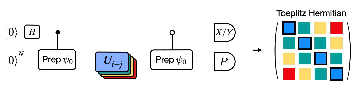

Efficient Hadamard test
We can optimize the deep circuits for the Hadamard test that we have obtained by introducing some approximations and relying on some assumption about the model Hamiltonian. For example, consider the following circuit for the Hadamard test:
Assume we can classically calculate E0E_0, the eigenvalue of 0N|0\rangle^N under the Hamiltonian HH. This is satisfied when the Hamiltonian preserves the U(1) symmetry. Although this may seem like a strong assumption, there are many cases where it is safe to assume that there is a vacuum state (in this case it maps to the 0N|0\rangle^N state) which is unaffected by the action of the Hamiltonian. This is true for example for chemistry Hamiltonians that describe stable molecule (where the number of electrons is conserved). Given that the gate Prep  ψ\text{Prep} \; \psi, prepares the desired reference state psi=Prep  ψ0=eiH0dtUψ0\ket{psi} = \text{Prep} \; \psi \ket{0} = e^{-i H 0 dt} U_{\psi} \ket{0}, for example, to prepare the HF state for chemistry Prep  ψ\text{Prep} \; \psi would be a product of single-qubit NOTs, so controlled-Prep  ψ\text{Prep} \; \psi is just a product of CNOTs. Then the circuit above implements the following state prior to measurement:
00NH12(00N+10N)1-ctrl-init12(00N+1ψ)U12(eiϕ00N+1Uψ)0-ctrl-init12(eiϕ0ψ+1Uψ)=12(+(eiϕψ+Uψ)+(eiϕψUψ))=12(+i(eiϕψiUψ)+i(eiϕψ+iUψ))\begin{equation} \begin{split} \ket{0} \ket{0}^N\xrightarrow{H}&\frac{1}{\sqrt{2}} \left( \ket{0}\ket{0}^N+ \ket{1} \ket{0}^N \right)\\ \xrightarrow{\text{1-ctrl-init}}&\frac{1}{\sqrt{2}}\left(|0\rangle|0\rangle^N+|1\rangle|\psi\rangle\right)\\ \xrightarrow{U}&\frac{1}{\sqrt{2}}\left(e^{i\phi}\ket{0}\ket{0}^N+\ket{1} U\ket{\psi}\right)\\ \xrightarrow{\text{0-ctrl-init}}&\frac{1}{\sqrt{2}} \left( e^{i\phi}\ket{0} \ket{\psi} +\ket{1} U\ket{\psi} \right)\\ =&\frac{1}{2} \left( \ket{+}\left(e^{i\phi}\ket{\psi}+U\ket{\psi}\right) +\ket{-}\left(e^{i\phi}\ket{\psi}-U\ket{\psi}\right) \right)\\ =&\frac{1}{2} \left( \ket{+i}\left(e^{i\phi}\ket{\psi}-iU\ket{\psi}\right) +\ket{-i}\left(e^{i\phi}\ket{\psi}+iU\ket{\psi}\right) \right) \end{split} \end{equation}
where we have used the classical simulable phase shift U0N=eiϕ0N U\ket{0}^N = e^{i\phi}\ket{0}^N in the third line. Therefore the expectation values are obtained as
XP=14((eiϕψ+ψU)P(eiϕψ+Uψ)(eiϕψψU)P(eiϕψUψ))=Re[eiϕψPUψ],\begin{equation} \begin{split} \langle X\otimes P\rangle&=\frac{1}{4} \Big( \left(e^{-i\phi}\bra{\psi}+\bra{\psi}U^\dagger\right)P\left(e^{i\phi}\ket{\psi}+U\ket{\psi}\right) \\ &\qquad-\left(e^{-i\phi}\bra{\psi}-\bra{\psi}U^\dagger\right)P\left(e^{i\phi}\ket{\psi}-U\ket{\psi}\right) \Big)\\ &=\text{Re}\left[e^{-i\phi}\bra{\psi}PU\ket{\psi}\right], \end{split} \end{equation} YP=14((eiϕψ+iψU)P(eiϕψiUψ)(eiϕψiψU)P(eiϕψ+iUψ))=Im[eiϕψPUψ].\begin{equation} \begin{split} \langle Y\otimes P\rangle&=\frac{1}{4} \Big( \left(e^{-i\phi}\bra{\psi}+i\bra{\psi}U^\dagger\right)P\left(e^{i\phi}\ket{\psi}-iU\ket{\psi}\right) \\ &\qquad-\left(e^{-i\phi}\bra{\psi}-i\bra{\psi}U^\dagger\right)P\left(e^{i\phi}\ket{\psi}+iU\ket{\psi}\right) \Big)\\ &=\text{Im}\left[e^{-i\phi}\bra{\psi}PU\ket{\psi}\right]. \end{split} \end{equation}
Using these assumptions we were able to write the expectation values of operators of interest with fewer controlled operations. In fact, we only need to implement the controlled state preparation Prep  ψ\text{Prep} \; \psi and not controlled time evolutions. Reframing our calculation as above will allow us to greatly reduce the depth of the resulting circuits.
