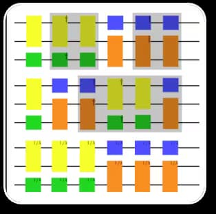

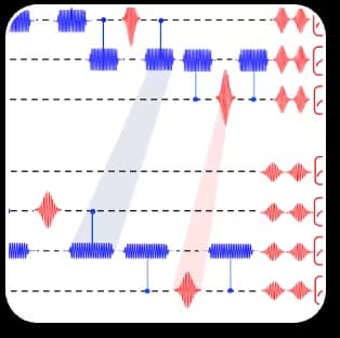

Pulse stretching
Gate folding
Probabilistic error amplification
Scale pulse duration via calibrationRepeat gates in identity cycles U↦U(U−1U)λ−1/2U\mapsto U(U^{-1}U)^{\lambda-1}/2Add noise via sampling Pauli channels
Kandala et al. Nature (2019)Shultz et al. PRA (2022)Li & Benjamin PRX (2017)

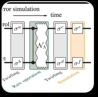

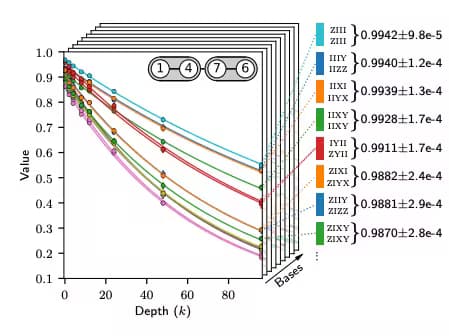

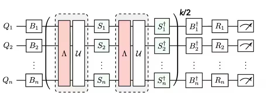

PEA assumes the same layer-based noise model as probabilistic error cancellation (PEC); however, it avoids the sampling overhead that scales exponentially with the circuit noise.
Step 1
Step 2
Step 3
Pauli twirl layers of two-qubit gatesRepeat identity pairs of layers and learn the noiseDerive a fidelity (error for each noise channel)

The PubResult object has additional resilience metadata about the learned noise models used in mitigation.
# Print learned layer noise metadata
for field, value in pub_result.metadata["resilience"]["layer_noise"].items():
    print(f"{field}: {value}")
Output:
noise_overhead: 9.2584227461744e+229
total_mitigated_layers: 18
unique_mitigated_layers: 3
unique_mitigated_layers_noise_overhead: [2.0713004613510885e+36, 10.600275591731494, 9.687147432958504]
