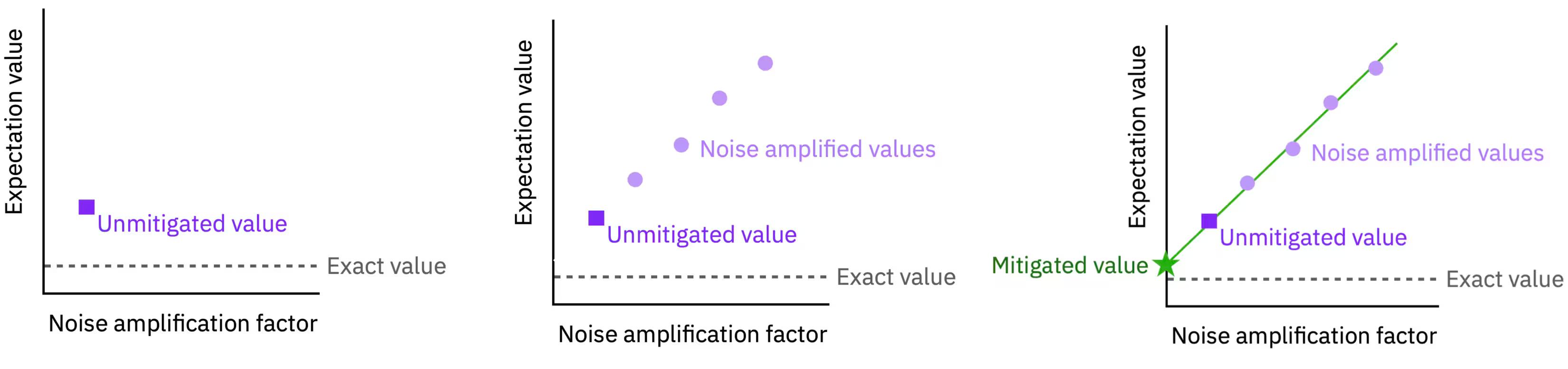

Zero-Noise Extrapolation (ZNE)
Zero-noise extrapolation (ZNE) is an error mitigation technique that removes the effects of an unknown noise during circuit execution that can be scaled in a known way.
It assumes expectation values scale with noise by a known function
A(λ)=A(0)+k=0makλk+R\langle A(\lambda) \rangle = \langle A(0) \rangle + \sum_{k=0}^{m} a_k \lambda^k + R
where λ\lambda parameterizes the noise strength and can be amplified.
We can implement ZNE with the following steps:
  1. Amplify circuit noise for several noise factors λ1,λ2,...\lambda_1, \lambda_2, ...
  2. Run every noise-amplified circuit to measure A(λ1),...\langle A(\lambda_1)\rangle, ...
  3. Extrapolate back to the zero-noise limit A(0)\langle A(0)\rangle

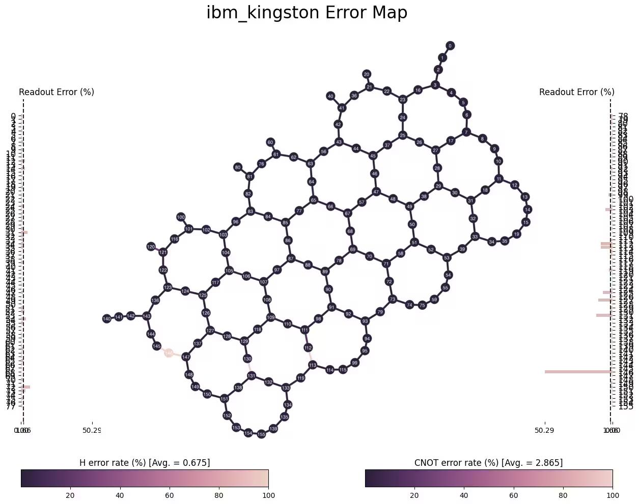

Remove bad qubits
Look at the coupling map for the backend and see if any qubits connect to couplings with high error. Remove these "bad" qubits from your experiment.
# Plot gate error map
# NOTE: These can change over time, so your results may look different
plot_error_map(backend)

bad_qubits = {
    56,
    63,
    67,
}  # qubits removed based on high coupling error (1.00)
good_qubits = list(set(range(backend.num_qubits)).difference(bad_qubits))

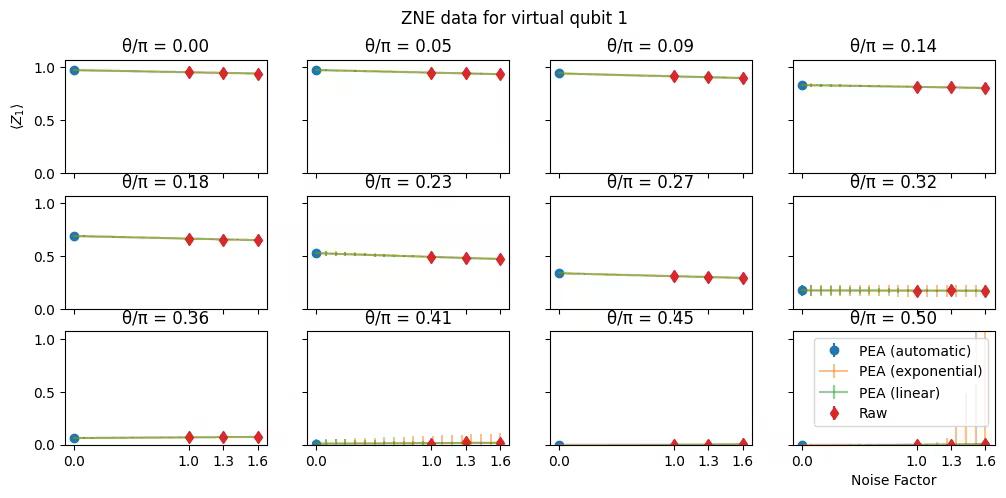

Step 4: Post-process and return result in desired classical format
Once the experiment is finished, you can view your results. You fetch the raw and mitigated expectation values and compare them with exact results. Then, plot the expectation values, both mitigated (extrapolated) and raw, averaged over all qubits for each parameter. Finally, plot expectation values for your choice of individual qubits.
primitive_result = job.result()
General result shapes and metadata
The PrimitiveResult object contains a list-like structure named PubResult. As we submit only one PUB to the estimator, the PrimitiveResult contains a single PubResult object.
The PUB (primitive unified bloc) result expectation values and standard errors are array-valued. For estimator jobs with ZNE, there are several data fields of expectation values and standard errors available in the PubResult's DataBin container. We will briefly discuss the data fields for expectation values here (similar data fields are available for standard errors (stds) as well).
  1. pub_result.data.evs: Expectation values corresponding to the zero noise (based on heuristically best extrapolation).
    • The first axis is the virtual qubit index for observable Zi\langle Z_i\rangle (124124 virtual-qubits/observables)
    • The second axis indexes the parameter value for θ\theta (1212 parameter values)
  2. pub_result.data.evs_extrapolated: Expectation values for extrapolated noise factors for every extrapolator. This array has two additional axes.
    • The third axis indexes the extrapolation methods (22 extrapolators, exponential and linear)
    • The last axis indexes the extrapolated_noise_factors (2020 extrapolation points specified in the option)
  3. pub_result.data.evs_noise_factors: Raw expectation values for each noise factor.
    • The third axis indexes the raw noise_factors (33 factors)
pub_result = primitive_result[0]
print(
    f"{pub_result.data.evs.shape=}\n"
    f"{pub_result.data.evs_extrapolated.shape=}\n"
    f"{pub_result.data.evs_noise_factors.shape=}\n"
Output:
pub_result.data.evs.shape=(153, 12)
pub_result.data.evs_extrapolated.shape=(153, 12, 2, 20)
pub_result.data.evs_noise_factors.shape=(153, 12, 3)

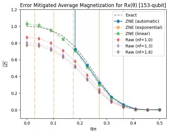

Plot Trotter simulation results
The following code creates a plot to compare the raw and mitigated experiment results against the exact solution.
"""Result visualization functions"""
def plot_trotter_results(
    pub_result: PubResult,
    angles: Sequence[float],
    plot_noise_factors: Sequence[float] | None = None,
    plot_extrapolator: Sequence[str] | None = None,
    exact: np.ndarray = None,
    close: bool = True,
    """Plot average magnetization from ZNE result data.
    Args:
        pub_result: The Estimator PubResult for the PEA experiment.
        angles: The Rx angle values for the experiment.
        plot_raw: If provided plot the unextrapolated data for the noise factors.
        plot_extrapolator: If provided plot all extrapolators, if False only plot
            the Automatic method.
        exact: Optional, the exact values to include in the plot. Should be a 1D
            array-like where the values represent exact magnetization.
        close: Close the Matplotlib figure before returning.
    Returns:
        The figure.
    data = pub_result.data
    evs = data.evs
    num_qubits = evs.shape[0]
    num_params = evs.shape[1]
    angles = np.asarray(angles).ravel()
    if angles.shape != (num_params,):
        raise ValueError(
            f"Incorrect number of angles for input data {angles.size} != {num_params}"
    # Take average magnetization of qubits and its standard error
    x_vals = angles / np.pi
    y_vals = np.mean(evs, axis=0)
    y_errs = np.std(evs, axis=0) / np.sqrt(num_qubits)
    fig, _ = plt.subplots(1, 1)
    # Plot auto method
    plt.errorbar(x_vals, y_vals, y_errs, fmt="o-", label="ZNE (automatic)")
    # Plot individual extrapolator results
    if plot_extrapolator:
        y_vals_extrap = np.mean(data.evs_extrapolated, axis=0)
        y_errs_extrap = np.std(data.evs_extrapolated, axis=0) / np.sqrt(
            num_qubits
        for i, extrap in enumerate(plot_extrapolator):
            plt.errorbar(
                x_vals,
                y_vals_extrap[:, i, 0],
                y_errs_extrap[:, i, 0],
                fmt="s-.",
                alpha=0.5,
                label=f"ZNE ({extrap})",
    # Plot raw results
    if plot_noise_factors:
        y_vals_raw = np.mean(data.evs_noise_factors, axis=0)
        y_errs_raw = np.std(data.evs_noise_factors, axis=0) / np.sqrt(
            num_qubits
        for i, nf in enumerate(plot_noise_factors):
            plt.errorbar(
                x_vals,
                y_vals_raw[:, i],
                y_errs_raw[:, i],
                fmt="d:",
                alpha=0.5,
                label=f"Raw (nf={nf:.1f})",
    # Plot exact data
    if exact is not None:
        plt.plot(x_vals, exact, "--", color="black", alpha=0.5, label="Exact")
    plt.ylim(-0.1, 1.2)
    plt.xlabel("θ/π")
    plt.ylabel(r"$\overline{\langle Z \rangle}$")
    plt.legend()
    plt.title(
        f"Error Mitigated Average Magnetization for Rx(θ) [{num_qubits}-qubit]"
    if close:
        plt.close(fig)
    return fig
zne_metadata = primitive_result.metadata["resilience"]["zne"]
# Plot Trotter simulation results
fig = plot_trotter_results(
    pub_result,
    parameter_values,
    plot_extrapolator=zne_metadata["extrapolator"],
    plot_noise_factors=zne_metadata["noise_factors"],
    exact=exact_data,
display(fig)
Output:
Output of the previous code cell
While the noisy (noise factor nf=1.0) values show high deviation from exact values, the mitigated values are close to exact values, demonstrating the utility of the PEA-based mitigation technique.
Plot extrapolation results for individual qubits
Finally, the following code creates a plot to show the extrapolation curves for different values of theta on a specific qubit.
def plot_qubit_zne_data(
    qubit: int,
    noise_factors: Sequence[float],
    extrapolated_noise_factors: Sequence[float] | None = None,
    num_cols: int | None = None,
    close: bool = True,
    """Plot ZNE extrapolation data for specific virtual qubit
    Args:
        angles: The Rx theta angles used for the experiment.
        qubit: The virtual qubit index to plot.
        noise_factors: the raw noise factors.
        extrapolator: The extrapolator metadata for multiple extrapolators.
        extrapolated_noise_factors: The noise factors used for extrapolation.
        num_cols: The number of columns for the generated subplots.
    Returns:
        The Matplotlib figure.
    evs_auto = data.evs[qubit]
    stds_auto = data.stds[qubit]
    evs_extrap = data.evs_extrapolated[qubit]
    stds_extrap = data.stds_extrapolated[qubit]
    evs_raw = data.evs_noise_factors[qubit]
    stds_raw = data.stds_noise_factors[qubit]
    num_params = evs_auto.shape[0]
        raise ValueError(
    # Make a square subplot
    num_cols = num_cols or int(np.ceil(np.sqrt(num_params)))
    num_rows = int(np.ceil(num_params / num_cols))
    fig, axes = plt.subplots(
        num_rows, num_cols, sharex=True, sharey=True, figsize=(12, 5)
    fig.suptitle(f"ZNE data for virtual qubit {qubit}")
    for pidx, ax in zip(range(num_params), axes.flat):
        # Plot auto extrapolated
        ax.errorbar(
            0,
            evs_auto[pidx],
            stds_auto[pidx],
            fmt="o",
            label="PEA (automatic)",
        # Plot extrapolators
        if (
            extrapolator is not None
            and extrapolated_noise_factors is not None
            for i, method in enumerate(extrapolator):
                ax.errorbar(
                    extrapolated_noise_factors,
                    evs_extrap[pidx, i],
                    stds_extrap[pidx, i],
                    fmt="-",
                    alpha=0.5,
                    label=f"PEA ({method})",
        # Plot raw
        ax.errorbar(
            noise_factors, evs_raw[pidx], stds_raw[pidx], fmt="d", label="Raw"
        ax.set_yticks([0, 0.5, 1, 1.5, 2])
        ax.set_ylim(0, max(1, 1.1 * max(evs_auto)))
        ax.set_xticks([0, *noise_factors])
        ax.set_title(f"θ/π = {angles[pidx]/np.pi:.2f}")
        if pidx == 0:
            ax.set_ylabel(r"$\langle Z_{" + str(qubit) + r"} \rangle$")
        if pidx == num_params - 1:
            ax.set_xlabel("Noise Factor")
            ax.legend()
    if close:
        plt.close(fig)
    return fig
virtual_qubit = 1
    pub_result=pub_result,
    angles=parameter_values,
    qubit=virtual_qubit,
    extrapolated_noise_factors=zne_metadata["extrapolated_noise_factors"],
Output:
